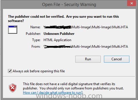

I did notice this... if I just open an command prompt and simply run the HTA application from there, I get this pop-up from Windows Security. We're all used to see that when running applications, but could that be what's causing the issue when trying to run from the TS? Like it's trying to pop-up and can't?
Might be making progress... Since this was downloaded from the Internet, it was set to be blocked in the properties and uploaded to the DP as such. Locally, I unblocked the application in the properties and ran it without getting the display shown above. Tried doing a simple Update DP and re-run the TS, but it remained the same. Will try to blow away the original package and re-create using the unblocked app tomorrow.
