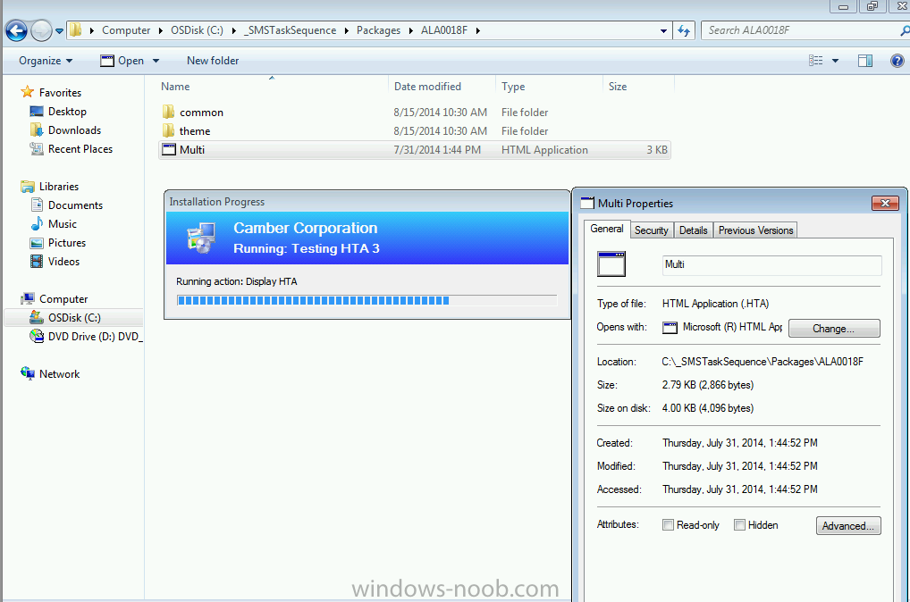

So after re-creating the package with the properties already set to unblock (seems that's really just a Windows 8 thing?), redistributing, and testing, I might have made progress, but still having the issue. On my test VM, using the test TS, I get the below screenshot. It's acting as if the HTA is displayed, because the TS is waiting. You can also see that I'm viewing the properties of the HTA as ran from the _SMSTaskSequence directory. However, the HTA is not showing.
I'm completely at a loss at this point. *beats head against wall*

Just an update. I've re-downloaded the Multi-Image zip, re-sourced, re-packaged, and redistributed it. Re-creating the TS media and.................... Works like a charm! Absolutely no earthly clue why the first time I downloaded it, it didn't work. But, I can overlook that... it only sort of bugs me LOL. Thanks again for all your time
