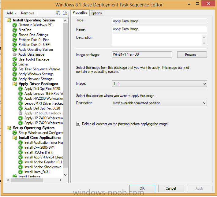

Hello all i am currently having an issue when i deploy a OSD task sequence to this device. If i leave secure boot and UEFI enabled and do a OSD task sequence it will run through the sequnence fine, but upon reboot it will say no boot device found. If i turn off UEFi and secure boot it will image correctly. Any help will do?

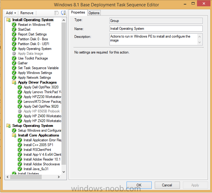

I resolved the issue. If you look at my task sequence I had a step called apply data image right after Apply operating system. If you look at settings I had for Apply data image you will see Set location where you want to apply this image i had next availabe Formatted partiton and the checkbox for delete all content on the partition befory applying image. So i decided to to launch cmtrace during the Task Sequence procces and behold upon reaching apply data image step I seeen in the log that C:\ drive was formatted. So thats why i got the error upon reboot "no boot disk found" thanks alot for the rapid feedback.
