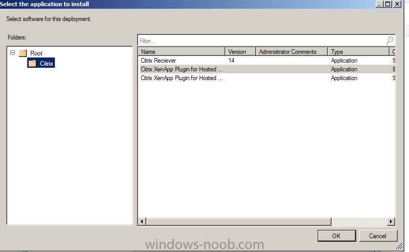

The one thing i noticed so i have created other citrix deployments but when i try to add it to the task sequence to install the app i only see one type of deployment.

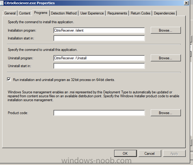

Also here is what i followed to created a deployment using an exe
http://gerryhampsoncm.blogspot.com/2013/03/sccm-2012-sp1-step-by-step-guide-part_20.html

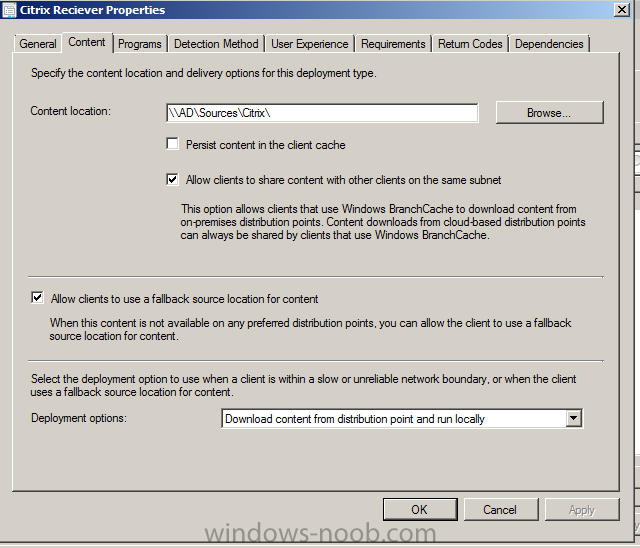

Found it! not sure how it got that path
\\ad\Sources\taskcitrixreciever_files\Content_1605b2bb-971e-4aea-b4cd-f156e5215222
should be
\\ad\sources\citrix

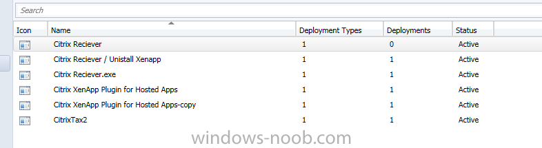

My question is why can i not add any of the other citrix applications? I figured out the error why it not install because i had to select download content
This error
Was fixed with
But still cant figure out why the applications i have created only one shows

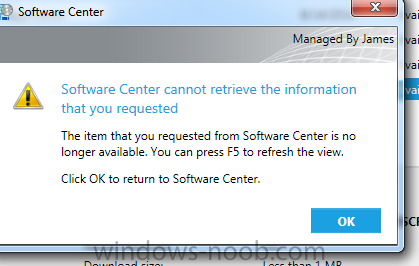

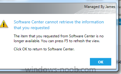

i have seen this error few days ago and it keeps prompting to refresh the view.So what i did was,reset the machine policy using sccm client center or using the script available from http://eskonr.com/2013/08/sccm-configmgr-2012-script-to-trigger-machine-policy-inventory-and-other-actions-on-clients/.
watch out for policyevalutor.log,policyagent.log (may takes couple of min ~5-10 min. and then try to run from software center.

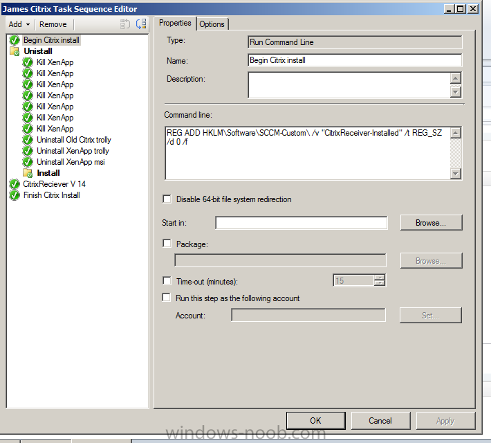

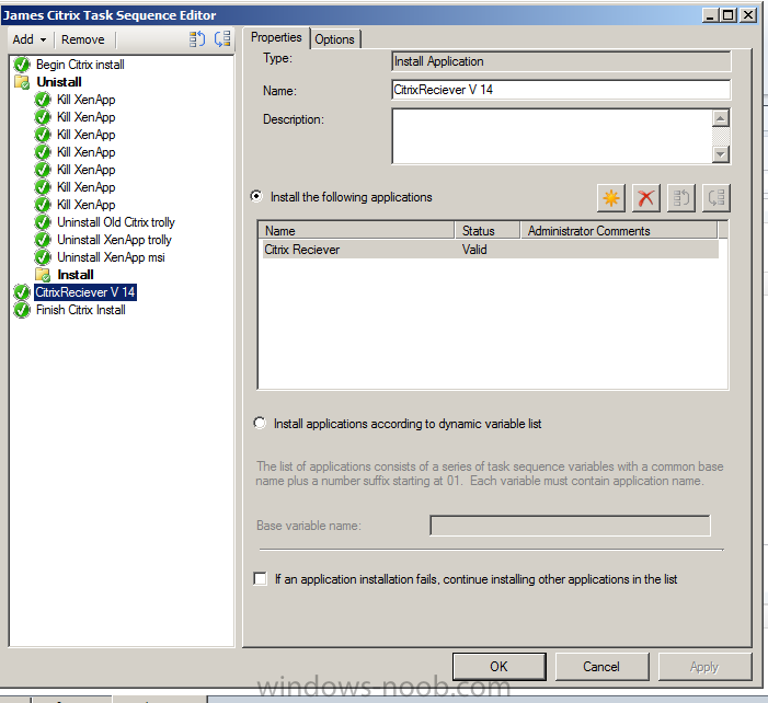

When i am in Software Lib-task sequence - custom sequence I am unable to add applications i just created.
I followed these directions
Found the issue Allow this application to be installed from the install application task sequence ...Needed to wait .
