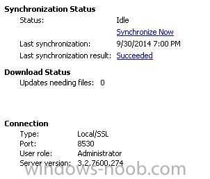

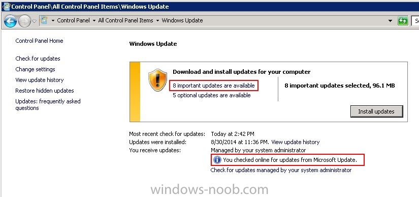

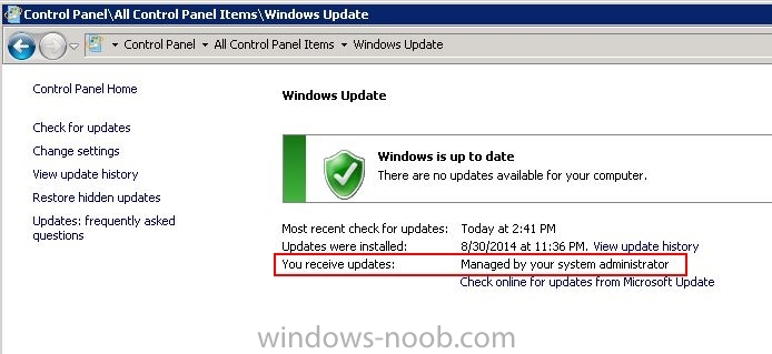

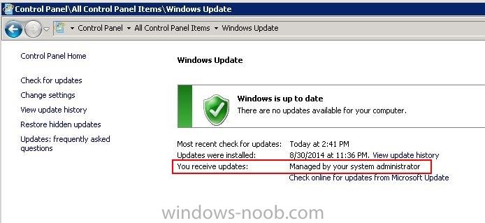

We have clients and servers that are not detecting the updates they need. When I go to the client and manually run the scan for Updates against the local WSUS is shows nothing needed. When I run the scan against Microsoft Online the workstation/server needs updates.

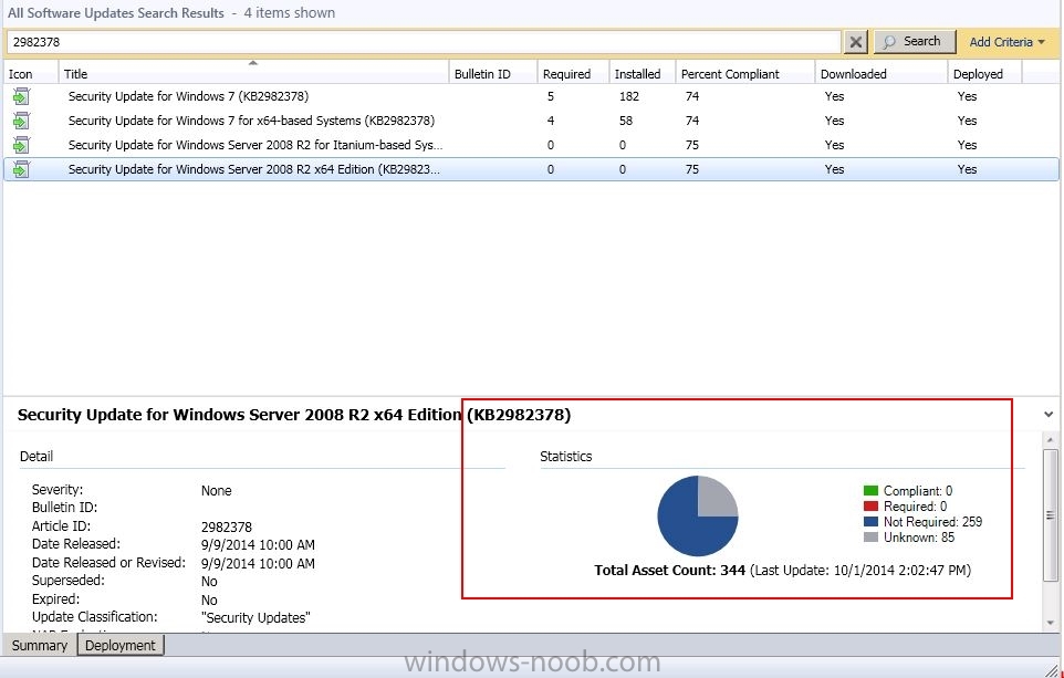

When I compare what is needed to what is downloaded/deployed SCCM shows that the server doesn't need the update. The WSUS shows the last sync time as yesterday as scheduled to.

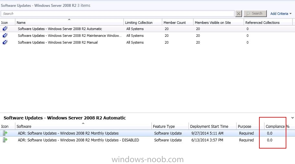

I have verified that the clients are part of the deployment rule but the rule shows 0.0% compliance.

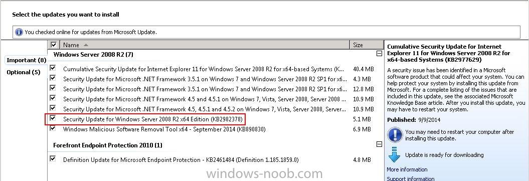

I'm comparing a particular patch that it shows that the system needs.
here is the question of the hour. Do you have SCCM clients installed on your server. You do not have to check for updates in control panel to check for updates once the client is installed.
You will also need to put your servers in an OU that has a group policy set for Windows udpates. The Intranet location to point to is your SUP server. eg. http://superver:8530
Once you do those two things, Windows updates will appear in Software Center on your server.
