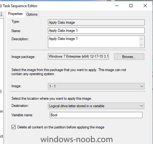

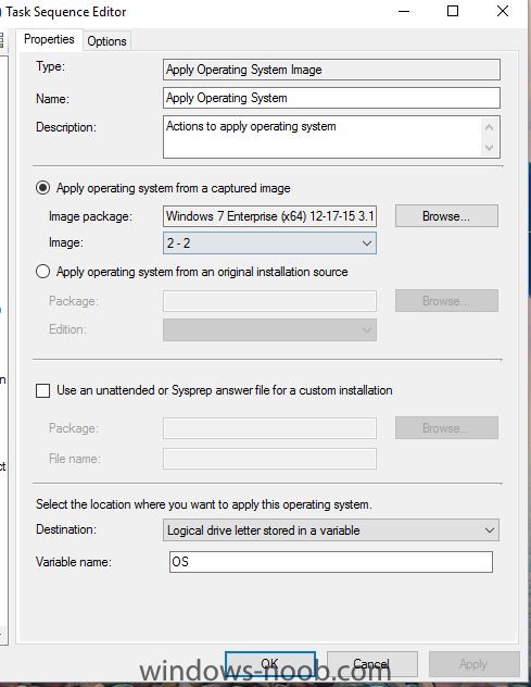

matt1234 Posted April 4, 2016 Report post Posted April 4, 2016 For Win 7 based machines depending how you captured, always make sure you have your image index's set correctly in the "Apply Operating System" and "Apply Data Image" steps. Apply OS Step: 2-2 Apply Data Image: 1-1 Quote Share this post Link to post Share on other sites More sharing options...
