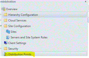

Dinus1979 Posted October 21, 2014 Report post Posted October 21, 2014 Boys are in total confusion I almost solved everything with your help, but in all this is added the PXE does not want to work !!! I redid everything: removed pxe removed wds restarted okay you create folders in REMOTEINST except SMSBoot HELP !!!! Quote Share this post Link to post Share on other sites More sharing options...

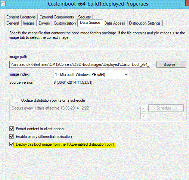

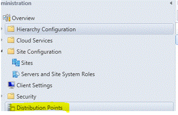

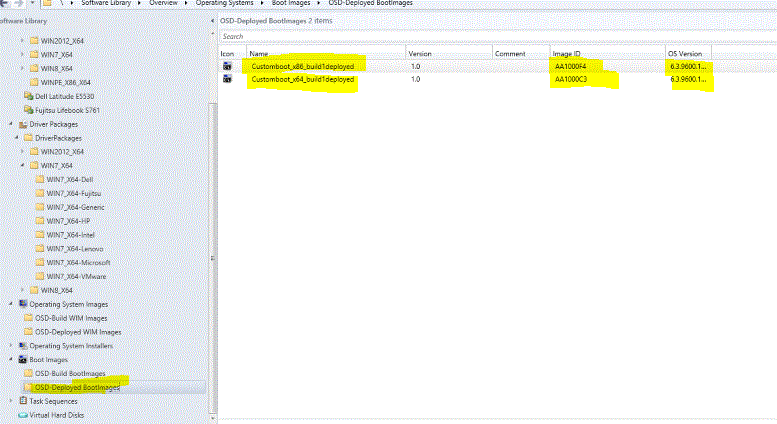

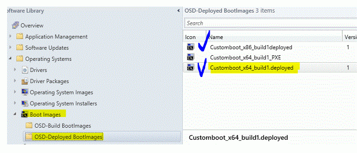

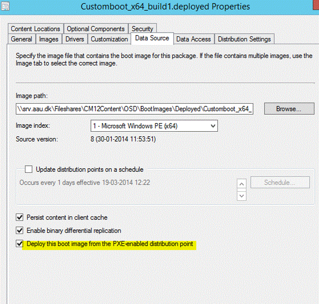

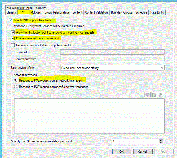

ludi2014 Posted October 21, 2014 Report post Posted October 21, 2014 0 Check the WDS Services make sure is started. if not start , you might need to restart the services. 1.Enable On dsitribution point PXE 2.Before you update boot image to Distribution point. Make Sure Deploy this boot image from the PXE service point for both boot image is checked (Very important) Make Sure Both of the Boot image is updated to Distribution point .(win_x64 boot images and win_x86_boot images.) try to find winpe boot images is copied to RemoteInstall\SMSImages folder Check now the WDS Services is started. if not start , you might need to restart the services. kind regards sg www.learnmesccm.com https://www.linkedin.com/pub/safet-grahic/a0/842/b21 Quote Share this post Link to post Share on other sites More sharing options...
Dinus1979 Posted October 21, 2014 Report post Posted October 21, 2014 The problem is this !!! When I load the two files to boot me from error and there is nothing in the folder SMSBoot Quote Share this post Link to post Share on other sites More sharing options...
