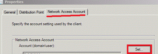

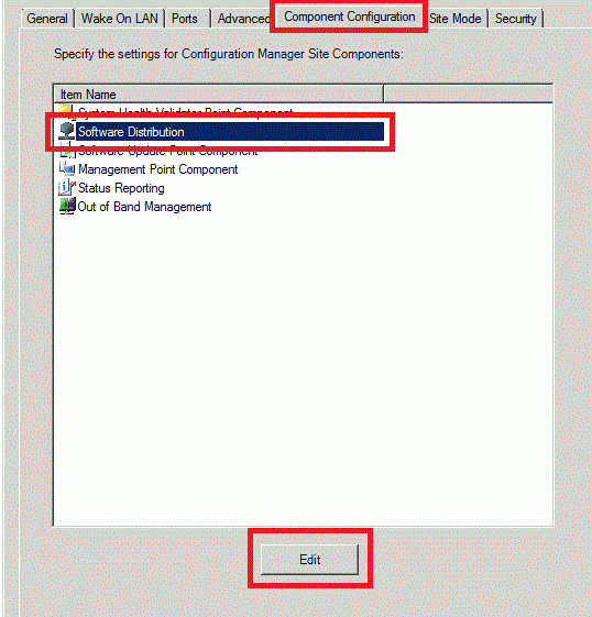

ludi2014 Posted October 21, 2014 Report post Posted October 21, 2014 0x80070002 Network accounnt on distribution point not assiggend Quote Share this post Link to post Share on other sites More sharing options...
Dinus1979 Posted October 21, 2014 Report post Posted October 21, 2014 sorry...but this screenshot are of SCCM 2007?? ...so the Network access account been configured Quote Share this post Link to post Share on other sites More sharing options...

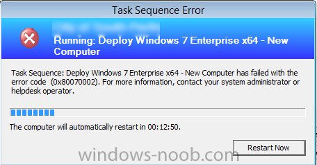

ludi2014 Posted October 22, 2014 Report post Posted October 22, 2014 Okey now you can start tasksequence and you got error 0x80070002. 1.which step in task sequence you get this error. 2.From the F8 prompt can you ping the MP/DP. 0x80070002 = "File not found". This is often seen when the DP can't be reached. 3. askTsequence of events is logged in SMSTS.log Task Sequence Stage WinPE - Before HD Format WinPE - After HD Format Windows - No Client Installed Windows x86 - Client Installed Windows x64 - Client Installed Task Sequence Completed x86 Task Sequence Completed x64 Log Location x:\windows\temp\smstslog\smsts.log x:\smstslog\smsts.log c:\_SMSTaskSequence\Logs\Smstslog\smsts.log c:\windows\system32\ccm\logs\Smstslog\smsts.log c:\windows\sysWOW64\ccm\logs\Smstslog\smsts.log c:\windows\system32\ccm\logs\smsts.log c:\windows\sysWOW64\ccm\logs\smsts.log kind regards sg www.learnmesccm.com Quote Share this post Link to post Share on other sites More sharing options...
Dinus1979 Posted October 22, 2014 Report post Posted October 22, 2014 On 10/22/2014 at 7:26 AM, ludi2014 said: Okey now you can start tasksequence and you got error 0x80070002. 1.which step in task sequence you get this error. 2.From the F8 prompt can you ping the MP/DP. 0x80070002 = "File not found". This is often seen when the DP can't be reached. 3. askTsequence of events is logged in SMSTS.log Task Sequence Stage WinPE - Before HD Format WinPE - After HD Format Windows - No Client Installed Windows x86 - Client Installed Windows x64 - Client Installed Task Sequence Completed x86 Task Sequence Completed x64 Log Location x:\windows\temp\smstslog\smsts.log x:\smstslog\smsts.log c:\_SMSTaskSequence\Logs\Smstslog\smsts.log c:\windows\system32\ccm\logs\Smstslog\smsts.log c:\windows\sysWOW64\ccm\logs\Smstslog\smsts.log c:\windows\system32\ccm\logs\smsts.log c:\windows\sysWOW64\ccm\logs\smsts.log kind regards sg www.learnmesccm.com Hi ludi, Now I'll explain calmly what I've done and where they are hopelessly stop: after reinstalling everything DP and PXE in the folder E: \ RemoteInstall \ SMSBoot find the following files: x64 folder x86 folder boot.sdi inside those folders there is nothing and when I go to load the Boot Images from SCCM in SMSPXE.log out the following error: I also tried to upload the files needed to boot in hand and deploy the part but I get the following error: despite having enabled F8 did not work when I do it and it captures everything! Quote Share this post Link to post Share on other sites More sharing options...

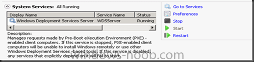

ludi2014 Posted October 22, 2014 Report post Posted October 22, 2014 Are you shure your wds service not fail with any error. tray to restart. I think if you have teamview i can fiks this for you. ssake2010@gmail.com www.learnmesccm.com LinkedIn Profil:http://dk.linkedin.com/pub/safet-grahic/a0/842/b21 Quote Share this post Link to post Share on other sites More sharing options...
Dinus1979 Posted October 22, 2014 Report post Posted October 22, 2014 On 10/22/2014 at 8:58 AM, ludi2014 said: Are you shure your wds service not fail with any error. tray to restart. I think if you have teamview i can fiks this for you. ssake2010@gmail.com www.learnmesccm.com LinkedIn Profil:http://dk.linkedin.com/pub/safet-grahic/a0/842/b21 The wds gives no error and it works. I do not have this server on the Internet are on an isolated network. How can I replicate the files in the folder SMSBoot ?? Quote Share this post Link to post Share on other sites More sharing options...
