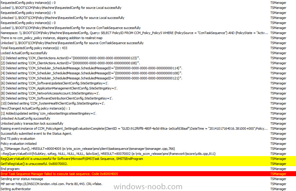

Here I'm deploying Windows 7 x64 and it installed perfectly fine onto the required Hardware
& VM.
Although in both platforms the Task Sequence fails straight away with the exact same error
in the SMSTS.log file.
I cant make heads or tails of the actual log file and needs some help to decode the endless
lines of code :(
Can someone point me in the right direction?

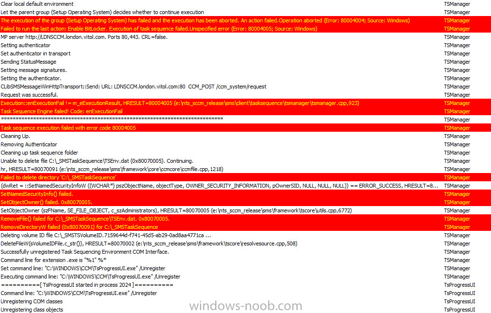

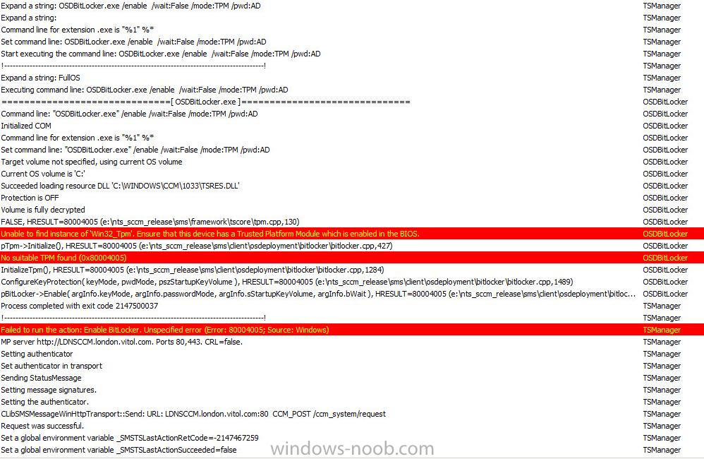

Oh, I had something like this.
It says you've got mistake with BitLocker step in your Task Sequence. I resolved that disabling the BitLocker step in TS :)
If you want to have setup BitLocker during the OS Deployment you need to check your BIOS Setup for that kind of settings.
Cheers.

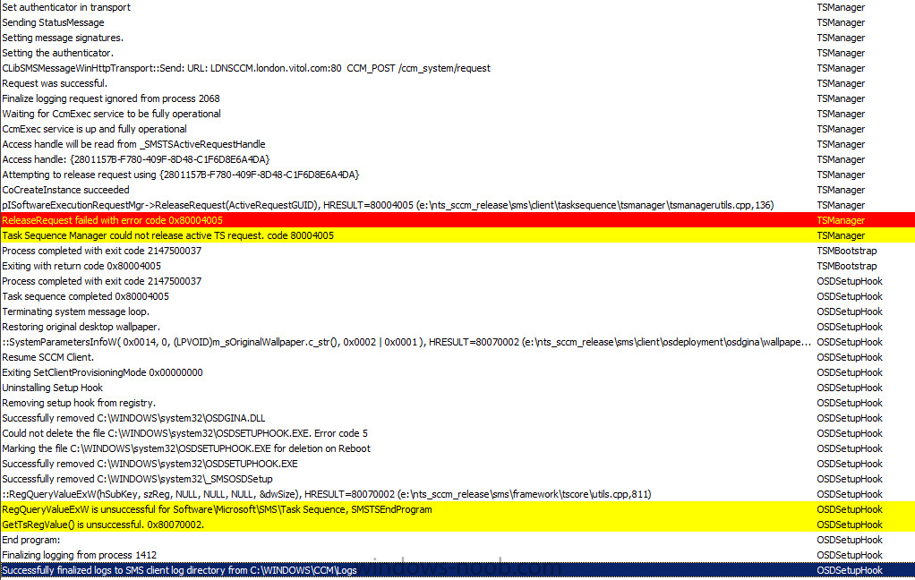

It's definitely failing because it's trying to install bitlocker, and cant find a TPM module to save the code to. The TPM error is a bit below the bitlocker error. Your also getting an error about the TS manager not being able to release an active TS request. Is it failing before Bitlocker, or while Bitlocker is trying to configure its self? If its failing before, try clearing any pxe requests for that machine/MAC address, and see if it goes farther then,
