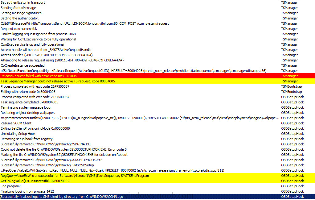

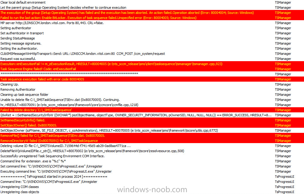

V1k45 Posted October 19, 2014 Report post Posted October 19, 2014 Hello Everybody, I am new to SCCM 2012 and have been struggling with an issue for the past 3 days and am tired of hitting my head against a brick wall. Here I'm deploying Windows 7 x64 and it installed perfectly fine onto the required Hardware & VM. Although in both platforms the Task Sequence fails straight away with the exact same error in the SMSTS.log file. I cant make heads or tails of the actual log file and needs some help to decode the endless lines of code Can someone point me in the right direction? Quote Share this post Link to post Share on other sites More sharing options...

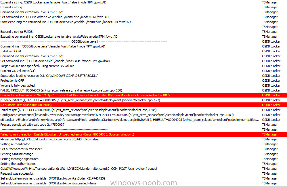

BigSteef Posted October 19, 2014 Report post Posted October 19, 2014 Looks to me like you are trying to enable bitlocker without the "skip if no TPM present" check box checked. And you have no TPM or its not enabled. Quote Share this post Link to post Share on other sites More sharing options...

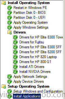

V1k45 Posted October 20, 2014 Report post Posted October 20, 2014 Hi BigSteef, Thanks for the input. I cleared out all the BitLocker parts from the TS and it looks like the new image i have uploaded. yet getting the same error :s This is nuts :s Quote Share this post Link to post Share on other sites More sharing options...
