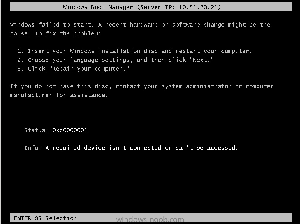

I create a new task sequence for deploy seven, it begins installatio, and at firt restart
Then it proceeds to loading the \SMSboot\boot.sdi. Some times it fails right here other times it proceeds to \SMSImages\SBG00043\winpe.SBG00043.wim. Either way it gets a bit into the progress bar but always fails

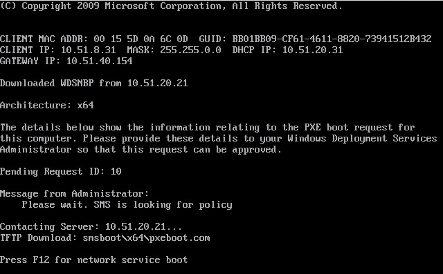

Kindly show me how to grab the file smsts.log before the message coming only have sort time after pressing f12 ?
enable command support in your boot wim, then redistribute your boot images to the dp, once done, pxe boot again, and immediatly after pressing F12, once WinPE loads, press F8, then grab the logs from x:\windows\temp\smstslog\smsts.log

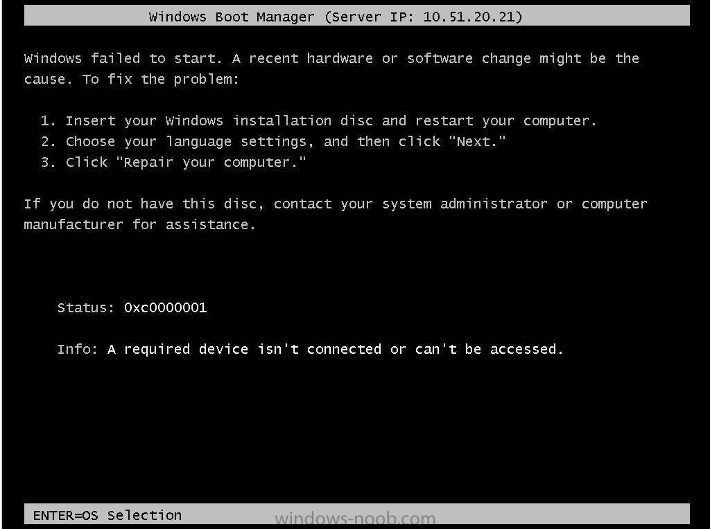

I tried these instructions and after repeatedly pressing F8, the command prompt does not show. I know this is enabled because it works on other models just not this one. I have loaded the drivers several times and still no go. I did notice that upon PXE boot the version shows 2.1.1.1 and my driver version is 2.1.1.27. Is this an issue or am I looking in the wrong place?
