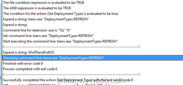

when you set the variable DeploymentType=Refresh it works, see the excerpt from the log
  Quote
Property DeploymentType is now = REFRESH
so that much works at least, the first real error is shown here
  Quote
Start executing an instruction. Instruction name: Validate.
Instruction pointer: 35.FAILURE ( 9809 ): Error - Performing a Refresh to a partition that does not match the current OS partition is not supported. You must perform a NewComputer deployment, aborting
