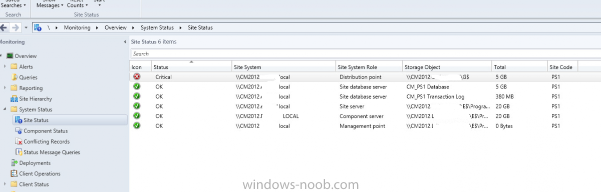

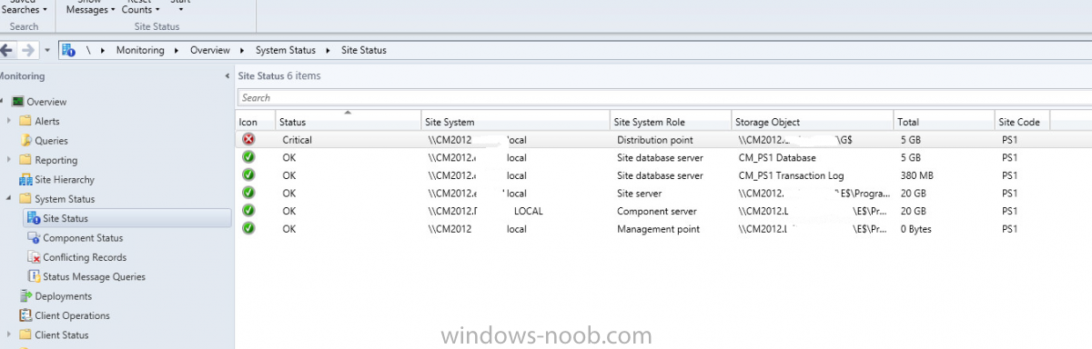

binarylab Posted February 1, 2015 Report post Posted February 1, 2015 Thank you for your help and quick response. I've removed DP and created NO_SMS_ON_DRIVE.SMS file on all volumes except for G: (its my content library drive). then I installed DP again with default settings and as you can see it looks better I'll install more site system roles and I want them to be installed on E: where my CM2012 installation is. I guess I have to remove NO_SMS_ON_DRIVE.SMS from E: before I install other roles. My another problem is/was the critical error on the distribution point. " Distribution Manager failed to process package "Configuration Manager Client Package" (package ID = PS100004). Possible cause: Distribution manager does not have access to either the package source directory or the distribution point.Solution: Verify that distribution manager can access the package source directory/distribution point. Possible cause: The package source directory contains files with long file names and the total length of the path exceeds the maximum length supported by the operating system.Solution: Reduce the number of folders defined for the package, shorten the filename, or consider bundling the files using a compression utility. Possible cause: There is not enough disk space available on the site server computer or the distribution point.Solution: Verify that there is enough free disk space available on the site server computer and on the distribution point..." I have solved this problem by adding my ConfigMgr computer to a local admin group but I wonder if it's the best practice even in the production environment? Quote Share this post Link to post Share on other sites More sharing options...
