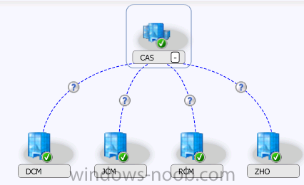

We have 4 Primary sites and one Central CAS Server. We lost the The CAS site by a HD failure. We only have a recent backup of the Site CAS Database only no backup for any configuration for the site.
We Prepared a new server did a Fresh installation of Windows 2008 R2 Sp1 install all Prerequisite for System Center Configuration Manager 2012 Sp1 and Run the Setup for Sysem Center Configuration Manager. I choose reinstall
1- Recover A Site
2- Reinstall this site Server (CAS Server)
3- Use a site Database that has been manually recovered. (I restored the last backup of the database)
Follow the Wizard, and the installation completed successfully.
Now when I am opening my CAS Console it is Read only mode. It has been like this since 24 hrs so far and no sign of improvement.
If I open any other primary site it is also in Read Only mode. All Site are in the unknow state, see attachements.
Is this a normal behavior? How Can I stop this replication?
