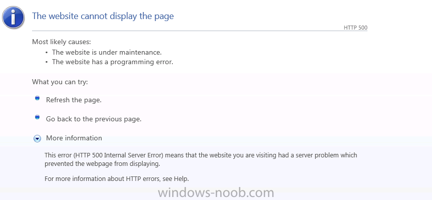

The problem is I am not able to login to the reporting service web console. The link is under Report Manager, and when I click on it, I get prompted to enter my credentials.
After I provide my credentials, the browser displays http error 500.
I have uninstalled and re-installed the reporting services role, confirmed that the SQL reporting services was configured properly, made registry changes etc. Yet, the problem continues to persist.
Please see the attached files for the log file and the HTTP error. Any help would be appreciated.
looks like from reading that log that your copsmgmtcomponent isn't initialized.
When you did the install did you ensure that SQL has the account you are using with permissions. Did you also ensure that your server instance is correct?
