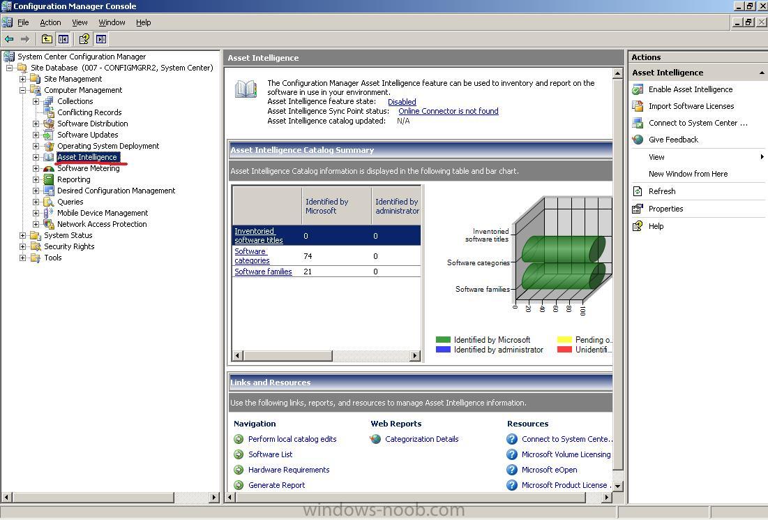

Expand the Computer Management node and click on Asset Intelligence.

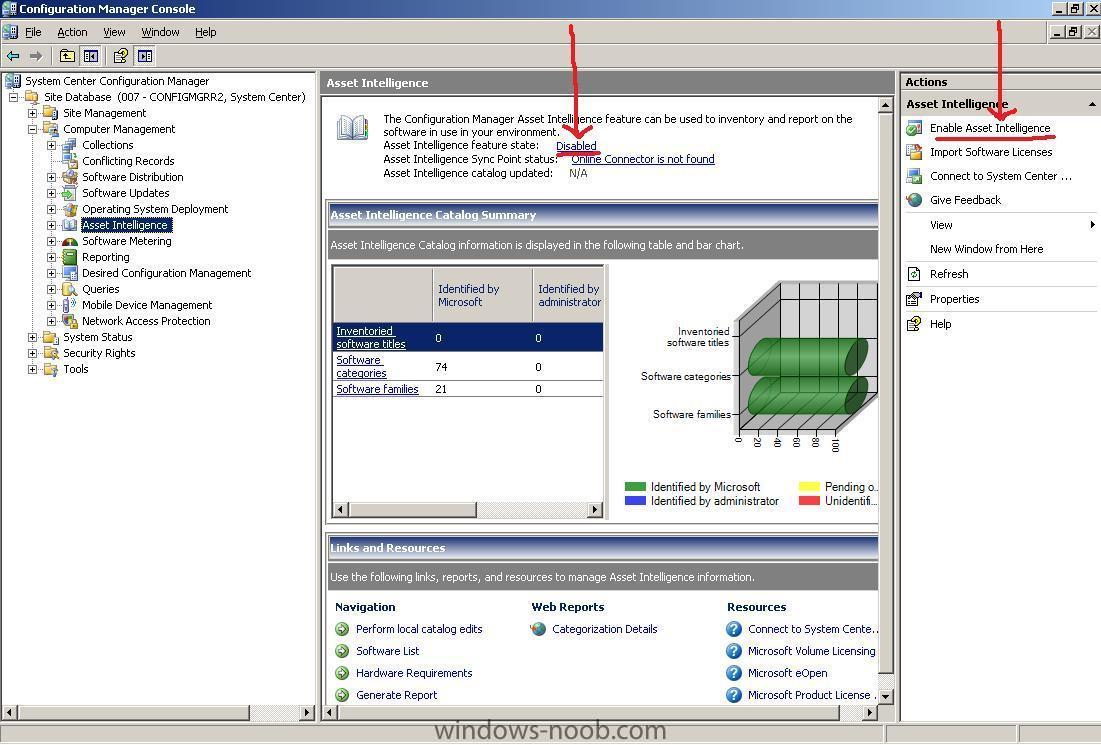

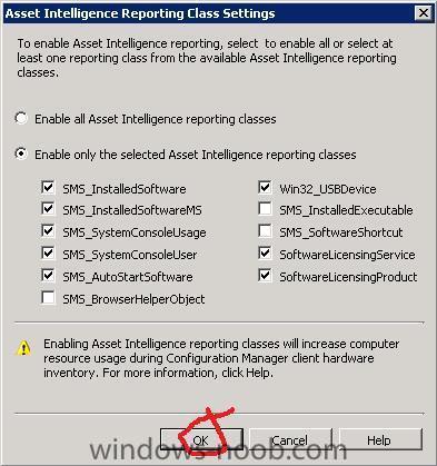

to start off you'll want to enable the feature, to do this you can expand the Asset Intelligence node and click on the disabled state (or click on Enable Asset Intelligence in the Actions Pane).

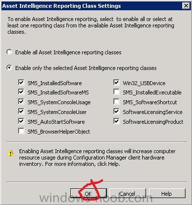

This will bring up a new window from which you can decide what Asset Intelligence reporting classes you want to enable. You must select at least one otherwise your reports based on those classes will contain no data. The more you enable the greater the hardware resource usage during the inventory.
Quote
Note:
Enabling Asset Intelligence reporting classes will increase computer resource usage during Configuration Manager client hardware inventory. To prevent unnecessary client computer resource usage, you should verify that only the reporting classes required to support the Asset Intelligence reports needed are selected.

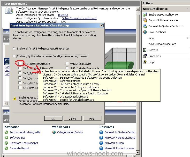

hover your mouse over a selection box and you'll be given information about what reports depend on the class.
select the classes that you will need and click ok

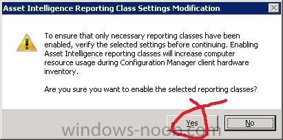

you will be prompted to verify the selected classes, if you are sure that they are ok (remember the more classes you enable the greater the increase in computer resource usage during the client hardware inventory) click Yes. We can always return here later and de-select classes if you don't require the info they gather.

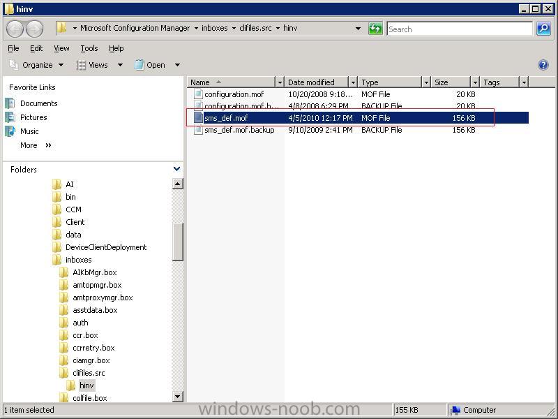

Browse to C:\Program Files (x86)\Microsoft Configuration Manager\inboxes\clifiles.src\hinv (change to the drive letter that you installed ConfigMgr on)
You will see that the SMS_DEF.MOF has now changed to today's date/time. This file represents the changes you have just made (open it, scroll to the bottom and you'll see all the Asset Intelligence classes listed).
