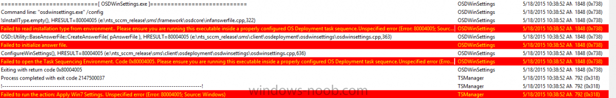

For example, for a test I did this afternoon, the "Apply Win7 Settings" step would fail which usually comes after Apply OS image, but as it's disabled, errored out with the below in logs:
Failed to read installation type from environment.. Please ensure you are running this executable inside a properly configured OS Deployment task sequence. Unspecified error (Error: 80004005; Source: Windows) (more below)

I created a Windows 7 image via imagedirect, downloaded it, and applied it to a test system. Currently, it would boot to Windows' mini-setup if powered on. I took our existing OSD TS and basically removed any steps where OSD applies the image, but steps which come after it that are still required are failing.
