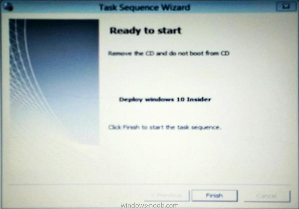

Task Sequence Wizard
This happens when the boot image that your Task Sequence is configured to use is different to the boot image that the machine actually started with. In ConfigMgr 2012, and if you're using PXE boot, the "default" boot image is the boot image from the most recently edited Task Sequence, therefore if the Task Sequence that the computer is supposed to run has a different boot image than the most recently edited Task Seqeunce, you get the above message.
