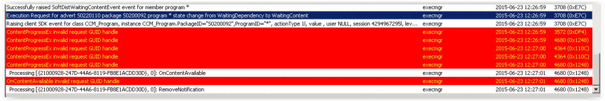

Hey,
Task Sequence is run on a system with an agent installed (mode: Required). When I assign a task to the collection Software Center shows the status "Downloading 0%" and nothing happens (all content is downloading properly to ccmcache). After removing Task Sequence from the collection and assign it again - he starts to work.
Log with execmgr.log when first TSQ assigned to collection Required Mode. TSQ Availably mode is working properly.
What does it mean?
"ContentProgressEx invalid request GUID handle"
