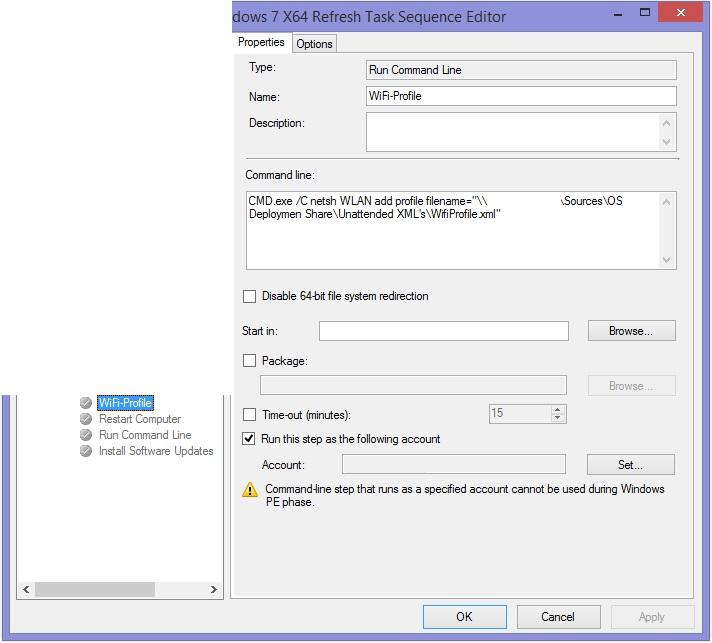

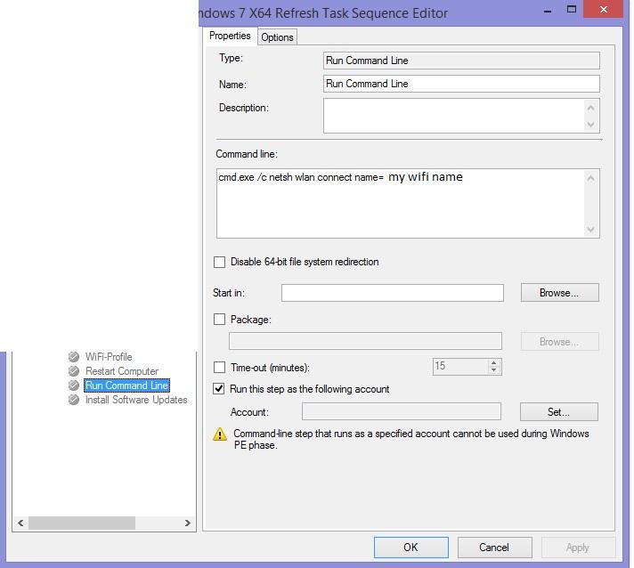

So I’m trying to add my Wi-Fi settings at part of my OSD task sequence however they don’t seems to be applying. They've added them right at the end so drivers ect are installed.
Ive created the XML using the netsh wlan export profile name=”SSID” then added it to sccm and distributed it.
As you can see in my screen shots
2 answers to this question
is there really spaces in your wifi ssid ?
also, you've checked the 'run as account' but havn't specified any, also deployment share is missing a 't'
with all these typos i'd double check what you've entered and if there's any spaces be sure to encapsulate them with " "
It’s just how I've edited my screenshots with my low skilled paint images :blink: , I’ve managed to work out what the problem was, i was capturing the wifi with this command netsh wlan add profile filename="WiFi.xml", however that means the password is encrypted so i used the command below and Bingo on first boot wifi is connected.
netsh wlan export profile key=clear
