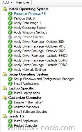

I'm very new to task sequences, so please bear with me on this. We're running System Center 2012 R2 Configuration Manager. I've been scouring the internet trying to fix several issues with the task sequence after recently making some changes. Everything was working fine before this:

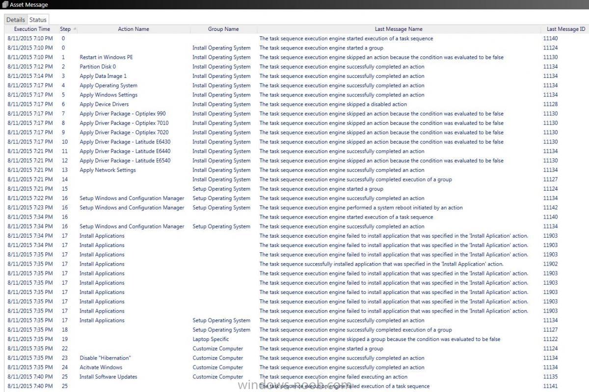

I have a new model laptop that I was trying to build a system CAB driver package for using a WMI query. I then added an "Apply Driver Package" step in the task sequence and distributed the content to our distribution points. Validation was successful, but the driver package showed a size of 0 MB in Configuration Manager. After that, anytime I tried to task sequence any model device it would immediately fail with "Could not find the specified drivers". I then removed the system CAB driver package and Apply Driver Package task in the task sequence. Now the task sequence runs, but consistently fails during the "Install Software Updates" process with error code "0x80004005". There are 8 software installations in the first "Install Applications" task, but only one of them actually installs (Microsoft Silverlight). The device is also not joining our domain despite making absolutely no changes to the "Apply Network Settings" task (it is instead joining a workgroup now). Comparing it to previous successfully deployed machines, it is failing at step 25 of 30 steps.

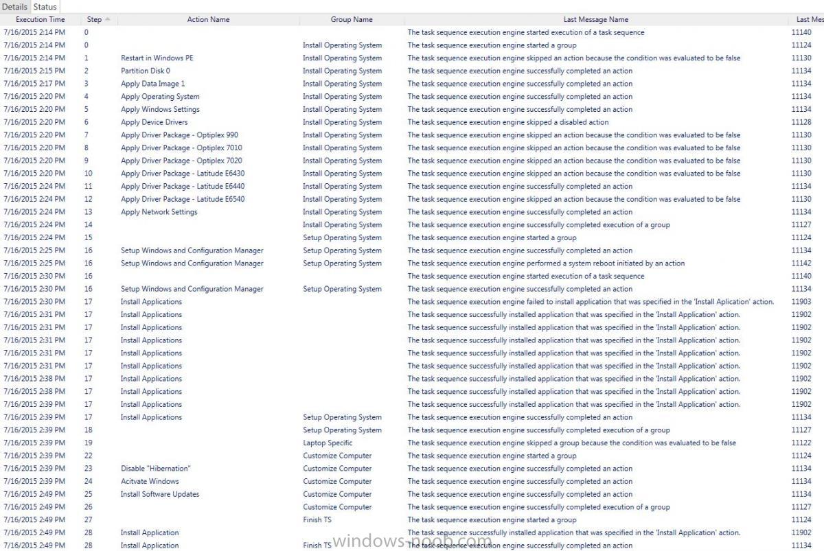

I've attached a screenshot of the Task Sequence, the deployment status of a Dell Latitude E6440 that worked prior to making these changes (Deployment Status - Working I & 2.jpg) and after (Deployment Status - Fail.jpg). I've also included the smsts log. I have absolutely no idea how adding and removing a driver package would've affected this or what to do next. I'd greatly appreciate any help or advice.
