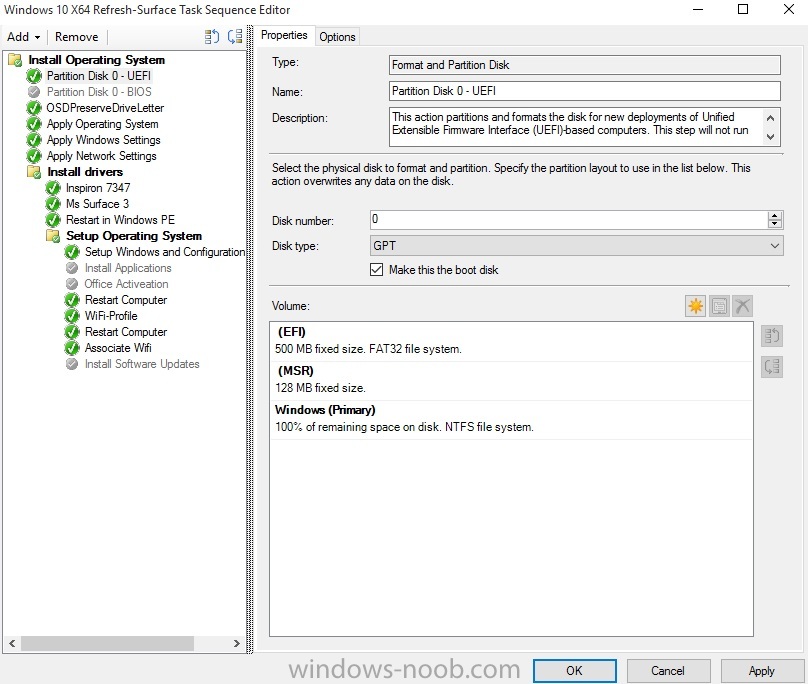

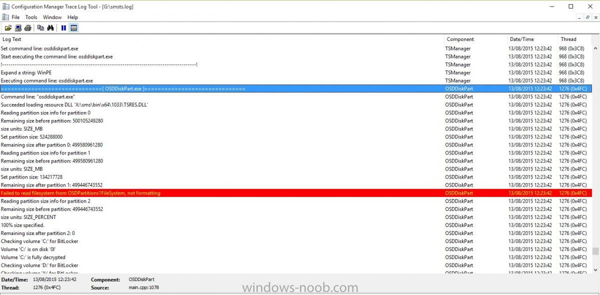

regan Posted August 13, 2015 Report post Posted August 13, 2015 currently trying to deploy my captured Windows image which i have no issues when using legacy method however im now using UEFI for the first time. Using the stand alone media USB option as i haven't setup Iphelpers on my HP switch's just yet. Seem to have an issue with formatting and partitioning the drive ready for the OS. I have attached the SMSTS and task sequence, the device did have bit locker enabled and UEFI enabled before running the task. Versions 2012R2 SP1 CU1, sever 2012. Quote Share this post Link to post Share on other sites More sharing options...

anyweb Posted August 13, 2015 Report post Posted August 13, 2015 please attach your actual smsts.log so i can take a look, did you create the partition UEFI step yourself ? Quote Share this post Link to post Share on other sites More sharing options...
regan Posted August 13, 2015 Report post Posted August 13, 2015 I used the automated way to create the UEFI partition. Thanks smsts.logFetching info... Quote Share this post Link to post Share on other sites More sharing options...
anyweb Posted August 13, 2015 Report post Posted August 13, 2015 Quote <![LOG[Process completed with exit code 0]LOG]!><time="12:23:50.448+480" date="08-13-2015" component="TSManager" context="" type="1" thread="968" file="commandline.cpp:1124"><![LOG[!--------------------------------------------------------------------------------------------!]LOG]!><time="12:23:50.448+480" date="08-13-2015" component="TSManager" context="" type="1" thread="968" file="instruction.cxx:805"> <![LOG[successfully completed the action (Partition Disk 0 - UEFI) with the exit win32 code 0]LOG]!> looks good to me, what happens after this ? Quote Share this post Link to post Share on other sites More sharing options...

regan Posted August 14, 2015 Report post Posted August 14, 2015 Thanks I've tried using DIskpart sadly no joy. After the partition stage i get the error message 0X80070057 during apply operating system stage. It turns out my OSDPreserveDriveLetter task was the issue so i have removed that. my next challenge will be to add drivers, install my wifi script thenSetup Windows and ConfigMgr join domain and finally the handy script Nial wrote with regards to adding a wifi mac address as the primary. Quote Share this post Link to post Share on other sites More sharing options...
