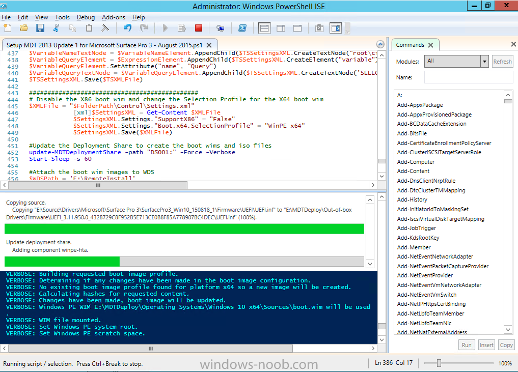

To use the script simply adjust the many variables within to suit your needs, then when you are ready, run it in PowerShell ISE.
The script will automatically download and install Windows ADK 10 and MDT 2013 Update 1. In addition, it will install Windows Deployment Services and after configuring the MDT DeploymentShare it will import the boot image into WDS. The boot image will have both the Surface Pro 3 100mb and gigabit network driver pre-installed. If you want to remove with, simply rem out the line in the script.

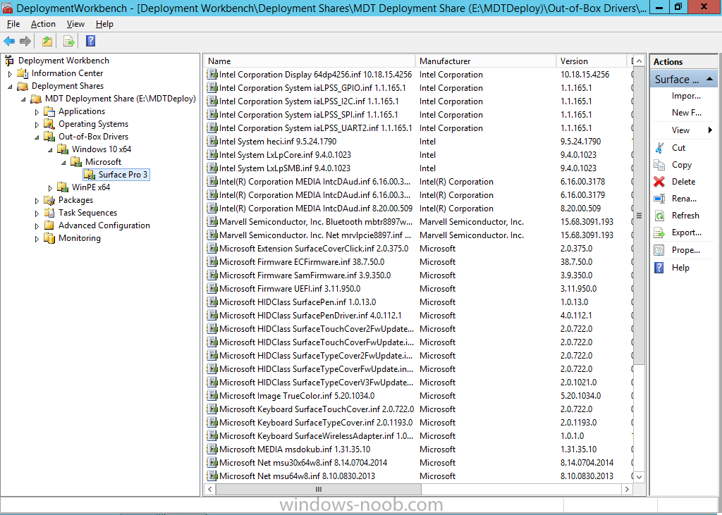

Speaking of drivers, the script will automatically download the latest drivers for Windows 10 for the Surface Pro 3 and import them into the MDT 2013 Update 1 deployment workbench.
Once the script is complete you can go ahead and launch the deployment workbench to review what has happened. Here you can see the drivers imported for the Surface Pro 3.

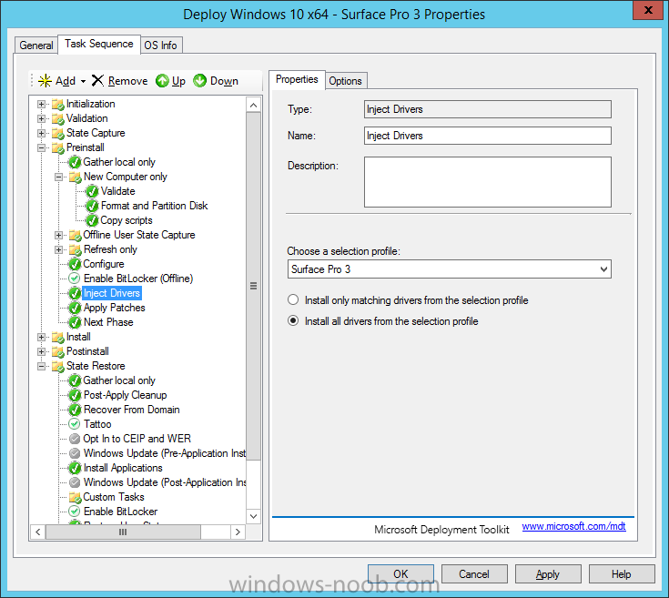

If you open the Deploy Windows 10 x64 - Surface Pro 3 task sequence you can see the inject driver step

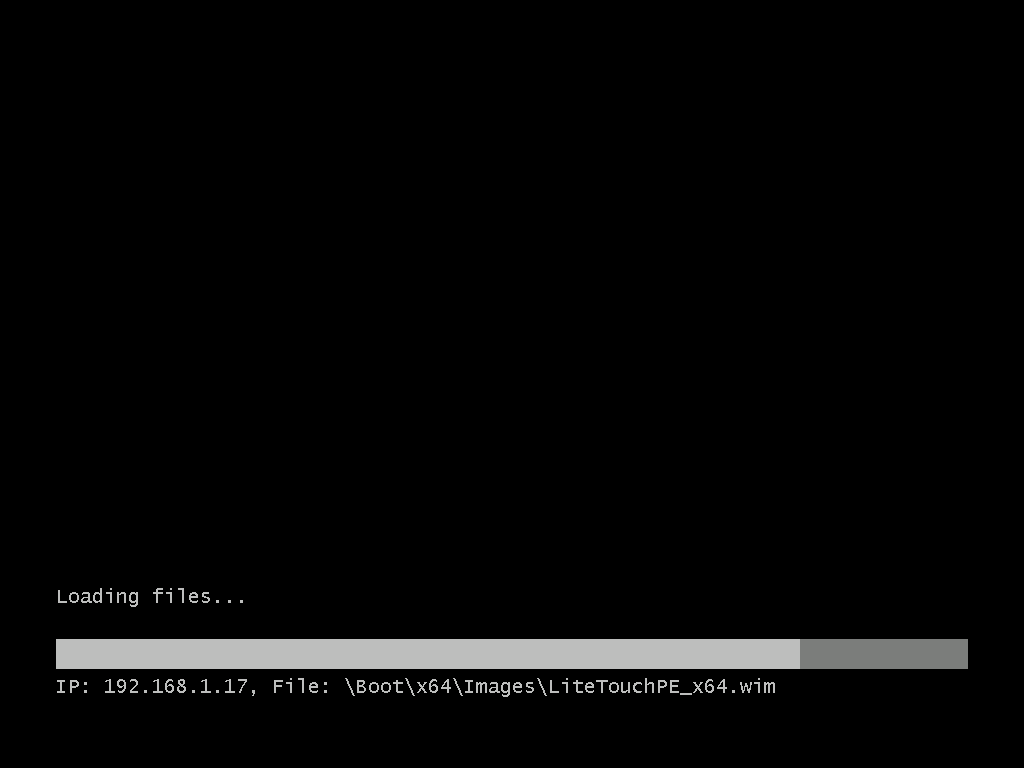

When you PXE boot (UEFI network boot) the Surface Pro 3, the correct x64 boot image containing NIC drivers for the Surface Pro 3 will be downloaded from WDS

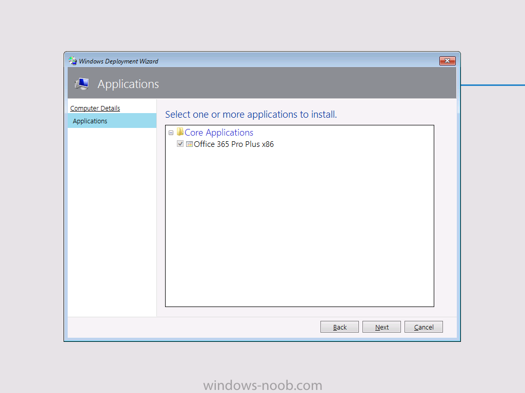

and select your core apps (Office 365)

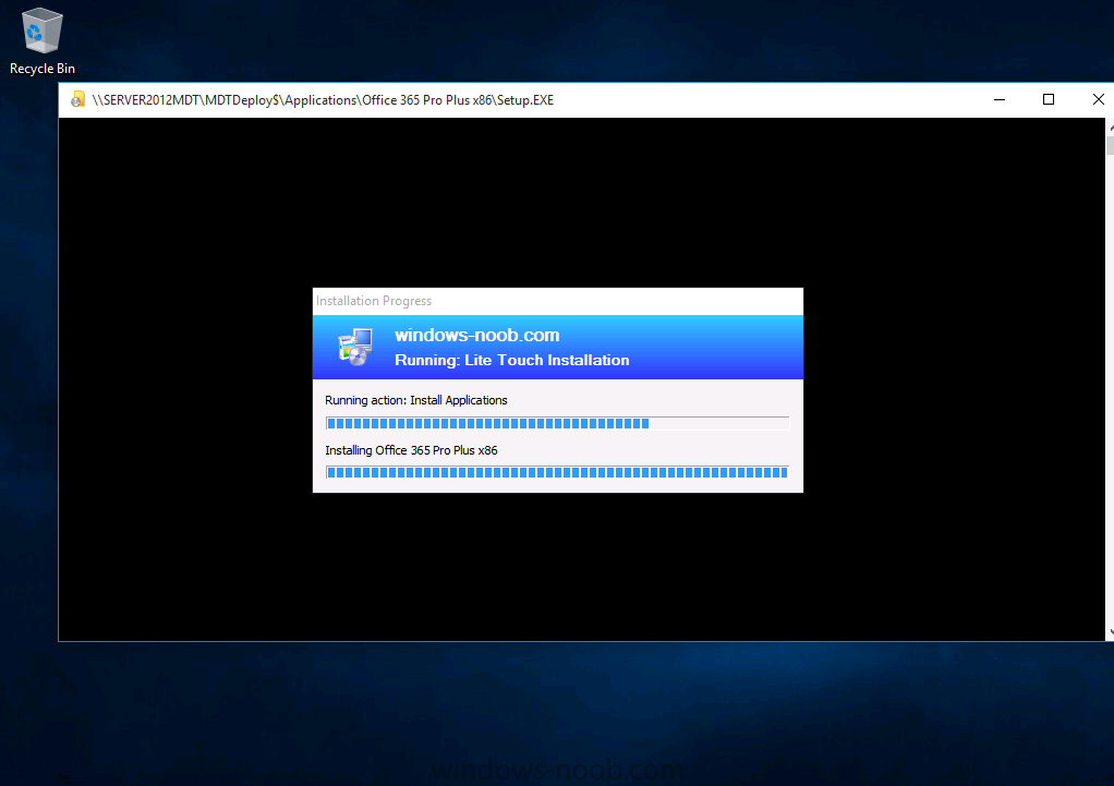

here you can see that Windows 10 x64 is already installed and now MDT is installing Office 365 Professional

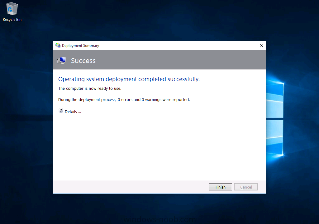

and after some time installing that, it's done !
