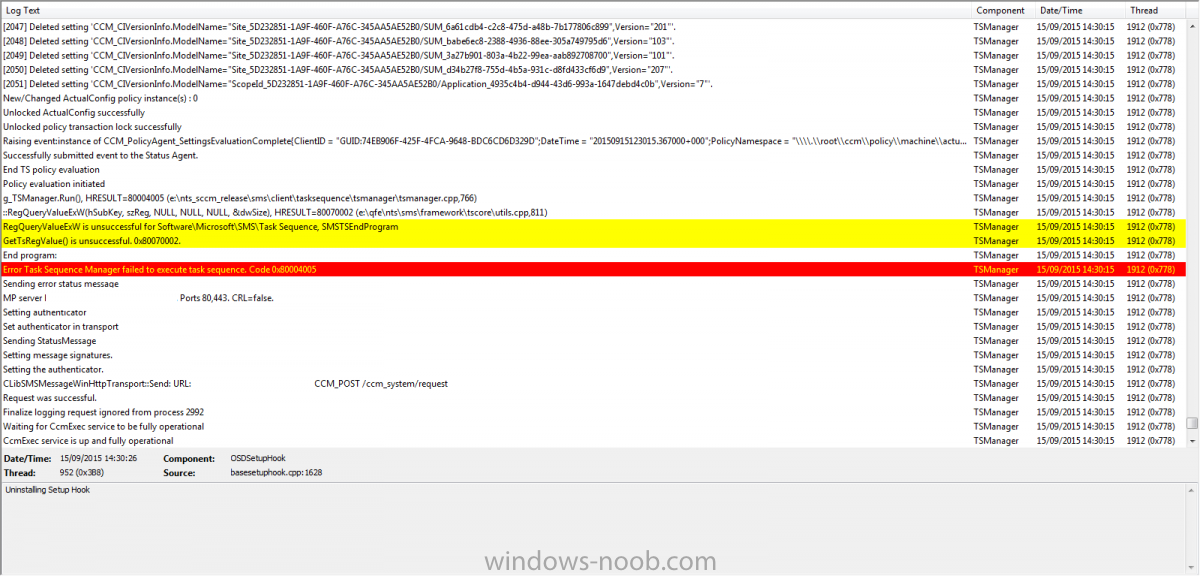

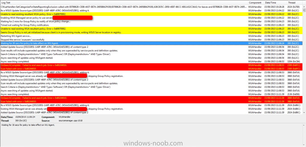

matteu Posted September 15, 2015 Report post Posted September 15, 2015 Hello, First, I prefer to say I'm french but I ll try to explain my problem in english. I have SCCM 2012R2 but I can't do a good OSD. If I don't put install windows update in my OSD, my OSD is perfect and no problem. If I put install windows update at the end, the TS launch the process, I can see install 1 of 140 etc until 140 of 140. I added 7 windows update on my install.wim the other are deployed during OSD TS After, the PC reboot, and the TS launch install Windows update 1 of 120 and never go to the end. I put some screenshot to explain my configuration and on updatesdeployment.log I have at 2.38 PMJob error (0x87d00665) received for assignment ({59F47E59-4E9B-422D-AFCF-F6425E7820DD}) action UpdatesDeploymentAgent 15/09/2015 14:38:53 4544 (0x11C0)Updates will not be made available UpdatesDeploymentAgent 15/09/2015 14:38:53 4544 (0x11C0) I hope you will be able to help my, I discovered this product on february, I think I use best practices for Application deployment but for OSD I can't find the solution.... There are two days I had my computer in provisioning mode, by addind software update I solved the issue but now, I encouter an other... thank you for your help Quote Share this post Link to post Share on other sites More sharing options...
