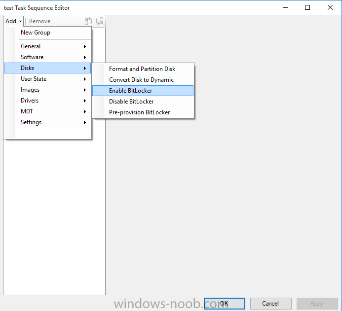

0 anyweb Posted September 22, 2015 Report post Posted September 22, 2015 so to understand your question you want to pre-provision bitlocker AFTER the os has laid down ? normally you pre-provision bitlocker at the beginning of the task sequence after formatting the disk to save time, why not use the built-in steps in a ConfigMgr task sequence for achieving this ? see screenshot below... Quote Share this post Link to post Share on other sites More sharing options...
0 Silencer001 Posted September 25, 2015 Report post Posted September 25, 2015 On 9/22/2015 at 7:23 AM, anyweb said: so to understand your question you want to pre-provision bitlocker AFTER the os has laid down ? normally you pre-provision bitlocker at the beginning of the task sequence after formatting the disk to save time, why not use the built-in steps in a ConfigMgr task sequence for achieving this ? see screenshot below... bitlocker steps.png Hi Niall, Thanks for your reply! This because the customer who wants to enable bitlocker in Windows 10 isn't using MDT/SCCM. They have created custom bootimages with custom scripts on a custom deploymentshare for their custom deployment framework.. Now they are looking for a standard script to enable bitlocker in their installation sequence. They still want to pre-provision bitlocker before the OS has been laid down. So is there a way to use the wsf/vbs scripts of MDT/SCCM outside of MDT/SCCM to accomplish the same thing?! Thanks in advance! Regards Quote Share this post Link to post Share on other sites More sharing options...
