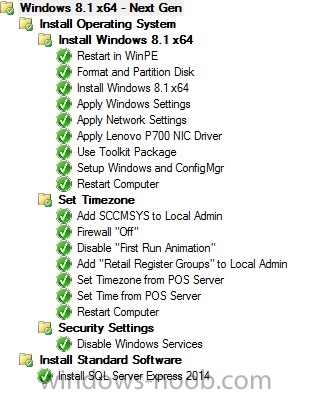

Problem: After the OS has been installed all other subsequent task sequences are bypassed.
Environment: Hyper-V 2012
Legacy "external" network adapter
Type 1 VM
I have created "bootable" media from my task sequence image and am loading my VM O/S from the DVD drive. It installs the OS, configure Windows setting, joins the domain and installs the SCCM client. After that it boots into the OS and finishes, ignoring the other task sequences. I have verified that the client is installed and active.
Is this an issue specific with Windows 8.1 and SCCM 2012 R@? I never had this issue with Windows 7.... :huh:
Have you tired removing the additional restart task you have attached directly after the configmgr agent installation.
The agent installation will restart by default (so no need for the additional restart step) and perhaps when it loads back up and initialises it does not have time to come out of provisioning mode due to the other restart?
