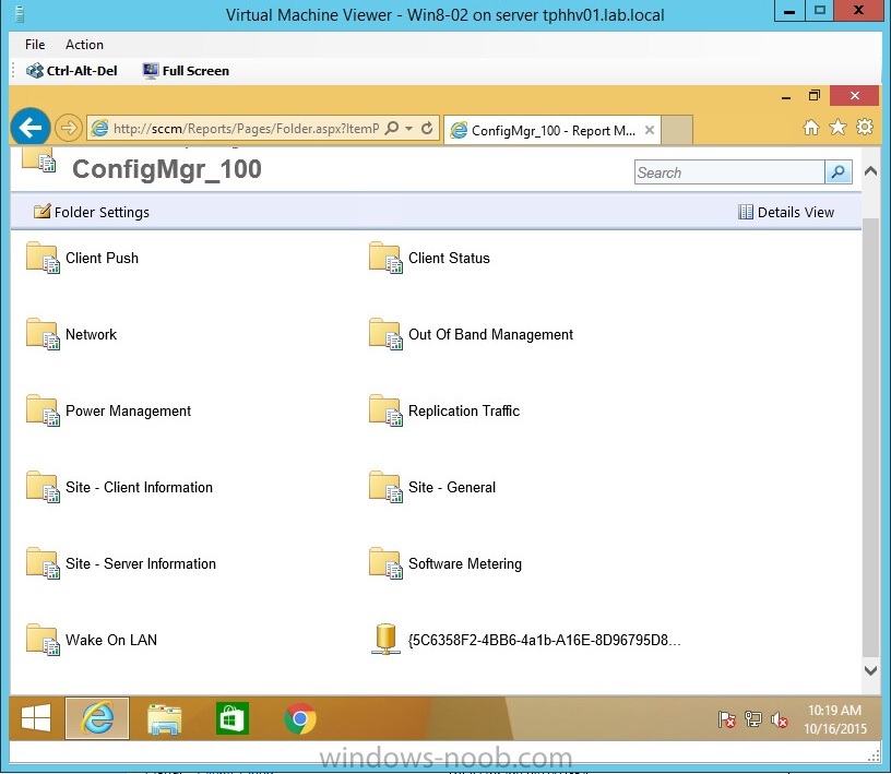

0 fsoares Posted October 14, 2015 Report post Posted October 14, 2015 ok.. i guess i am almost there... i can still see the reports folders but no reports... any idea why the permissions on the folders are reverting ? Quote Share this post Link to post Share on other sites More sharing options...

0 fsoares Posted October 14, 2015 Report post Posted October 14, 2015 What i would like to do is when the user goes to the reports website he would only see the reports and folders i gave him permissions to. i only have the default reports and folders that come with the installation. I can do it.. but the permissions revert. right now i removed the users from the reports, one by one, and also remove the "inheriting rights from parent objects" in the sccm console. But when the user goes to the reports website, he can see the folders, all the folders but no reports, which is part of what i want to do. When i go to the permissions on the reports website and remove the use from the folder, those are the ones that revert after 10 minuts... and the user can see the folder again. Quote Share this post Link to post Share on other sites More sharing options...
