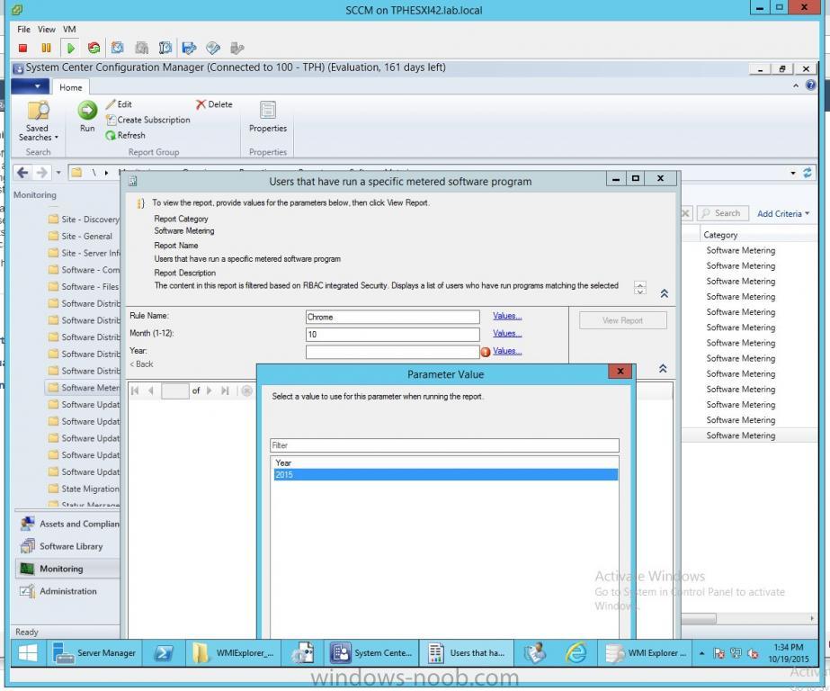

0 fsoares Posted October 19, 2015 Report post Posted October 19, 2015 from my understanding the client is logging the information.. the problem is , i think for some reason she is not being sumarized or sent to the server... because when i go create a report on software metering reports... the filders that i should select the Month and Year.. are empty .. in the lab i have them because i executed the utility to for the sumarization. Quote Share this post Link to post Share on other sites More sharing options...

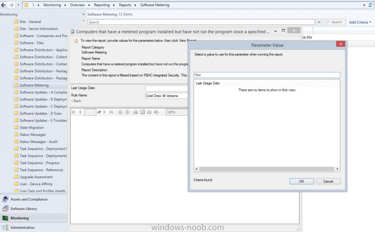

0 fsoares Posted October 19, 2015 Report post Posted October 19, 2015 yes i did run and the mtgmgr.log shows that he matches processes with the rules. Example.. i am running a notepad rule to see if it triggers... and he does. for the Corel rule i created.. i cant see anything in the logs... because the logs only go so far back in time... i am trying to run, in the software metering reports, any of them .. and i dont get data.. see the print. Quote Share this post Link to post Share on other sites More sharing options...

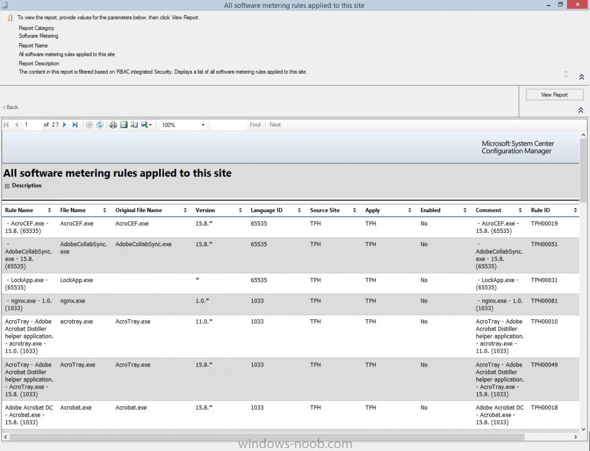

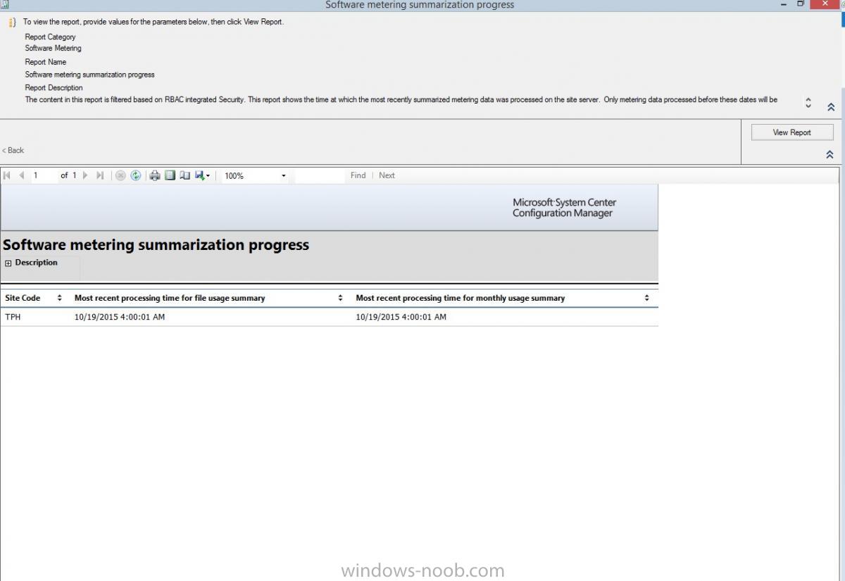

0 GarthMJ Posted October 19, 2015 Report post Posted October 19, 2015 First off I never recommend accessing the reports via the console too much overhead too many issues. Instead only access then via the web. Second start with a simple report. All software metering rules applied to this site. then run Software metering summarization progress then run Quote Share this post Link to post Share on other sites More sharing options...
0 fsoares Posted October 19, 2015 Report post Posted October 19, 2015 Ok.. now what ? Quote Share this post Link to post Share on other sites More sharing options...
