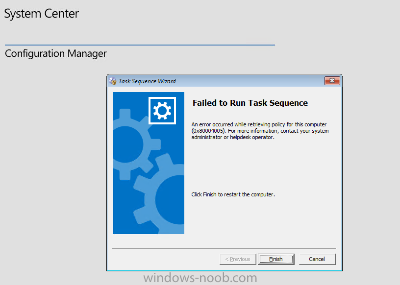

I just updated a SCCM server with the CU1 (for the R2 SP1). After the update, when I try to boot with a bootable media mounted, it looks all good. I click on next to view the task sequence and it fails. This was working until I patch with CU1.
From the SMSTS.log:
CryptVerifySignature (hHash, pSignature, dwSizeSignature, hKey, NULL, 0), HRESULT=80090006 (e:\nts_sccm_release\sms\framework\osdmessaging\libcrypt.cpp,642) TSMBootstrap 10.11.2015 23:53:54 1920 (0x0780)
CryptVerifySignature failed, 80090006 TSMBootstrap 10.11.2015 23:53:54 1920 (0x0780)
VerifySignedString (sAnsiCert.getBuffer(), m_sMPCertificateSignature.c_str(), szTrustedRootKey, 32780 ), HRESULT=80090006 (e:\nts_sccm_release\sms\framework\osdmessaging\libsmsmessaging.cpp,5387) TSMBootstrap 10.11.2015 23:53:54 1920 (0x0780)
untrusted certificate: 308202EF308201D7A00302010202103F2F58B02BD4A48046A24966EFD8A8C1300D06092A864886F70D01010B05003026311630140603550403130D4857494750565053434D303031310C300A06035504031303534D533020170D3135303631343231353530335A180F32313135303532323231353530335A3026311630140603550403130D4857494750565053434D303031310C300A06035504031303534D5330820122300D06092A864886F70D01010105000382010F003082010A02820101009D05AB2CF0FF2CF396D4421B7BB5200F28D74CED3F2165F0E8C008533ECD62630208DEDC707FEDE6B6F0664A51829BA6A412960996665BF6E9631903D17E60BA666C50EB1996E0A650B25A00AB09352A39C93ABA89C36951F88B92B01B0784179AEF6D740379323CE8B68E2D6B3EF18014EDDE4F8881958963A5EFA0DB578B1B02BCB64403786D8CB456C4BD2A0AC94CD87AD0AFC3EF786A2BF1B1338C75A323BC6427655BCBFEE503BD2FAD07DA6EAE95A5983B80C89C483315069B4BA34AB3BD8838CE6FB8CFDA0D67AC7C39EA650081470F8D81245425B7FA49C5720F6C3ABEE6969D998A326D2172E81C1F3D698450507A0B6D9E575D009F4412A07AB9610203010001A317301530130603551D25040C300A06082B06010401823765300D06092A864886F70D01010B0500038201010066687B1227B20D12DD2F23F3C64E3D736A525898508F8A7FF936522C6885BB7271C86F1E4F491AD4B3B0C0DB35415D6E5550451509D35CFD93FFF5CA3317618BB99D05D2D39EE3E72650F2D1D6DF627469315E229A79918FD55013525771994C46402DF79B54B6F3F2A8320D3BAC2FBFCB951F54936AE1713E217CB7712440CC8097E06FE53D48988BC93F6BA75181AABC1B8409C38C27D816A1A377CFB968D15D648B902790C48C1131529951E5BA174D58DDD88B083C120D3DD221DCAC161C3B79A410DDC01154DCCA2437A346AE5EFC85398BE650762DA13F18167C0FE40C31711C7143E44D9BA233A5B245D27ED49FA313CF1BEA2A1BC684D26002D21D8C, , 0602000000A40000525341310008000001000100C781D94CA72A91BD0315C67676BA325A9C464D0AB180223BEF2E4F5AAAC426A4B7A7F5C22FB3CCB907F8C752681917679430CDBFD9427B956A6A776C3B20712C338D93A0DDF7970056C2D39569368502897CD0E267E559DBAE2788F80698AFFE20113DDF95798868EF728BC6AC7B515F34C21E94169D8EA78B0AD49FD00B5BF3F9CEC1DD9A42AFB484AC6782F35FD3892D080B4693DA560D2FC0799DE75DD07A93940C42210EF20C417AD991E4EF3AE80598C0ABCEE3963EC4897F4F69167A2585F94383B6D625BBAD988FBE9646B8235B3FD064E735A4D5D6A0E7AFF1936DBEE02F0F729B43224F165FC7EF389F09E25920281E85B03AB534B03DDF2DCC2EB1 TSMBootstrap 10.11.2015 23:53:54 1920 (0x0780)
MPKeyInformation.RequestMPKeyInformationForMedia(szTrustedRootKey), HRESULT=80090006 (e:\nts_sccm_release\sms\framework\osdmessaging\libsmsmessaging.cpp,9584) TSMBootstrap 10.11.2015 23:53:54 1920 (0x0780)
Failed to get information for MP: http://SCM. 80090006. TSMBootstrap 10.11.2015 23:53:54 1920 (0x0780)
I have already look into the certificates and everything is "unblocked". I have created another bootable image from the task sequence media, with a long date on the certificate self-sign.
The error on the screen is this:
Any help will be very very appreciate!! :D:D:D:D:D
