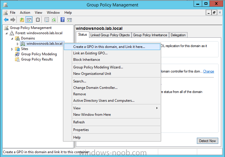

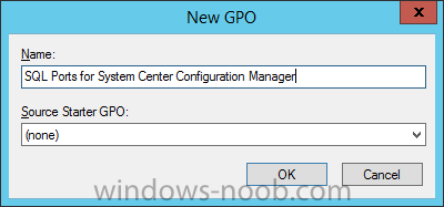

To allow SQL to replicate data, open the following TCP ports in the Configuration Manager firewall, 1433, 4022. You can do this by targetting your ConfigMgr servers with a GPO. To create the GPO do as follows. Start the Group Policy Management tool (GPMC.MSC) and create a new GPO.
Note: In the example screenshot below I link the GPO to the domain GPO however you should consider creating an OU specifically for your Configuration Manager servers and target this GPO only to that OU (your Configuration Manager servers require this GPO for SQL replication).
Give the GPO a name such as SQL Ports for System Center Configuration Manager.

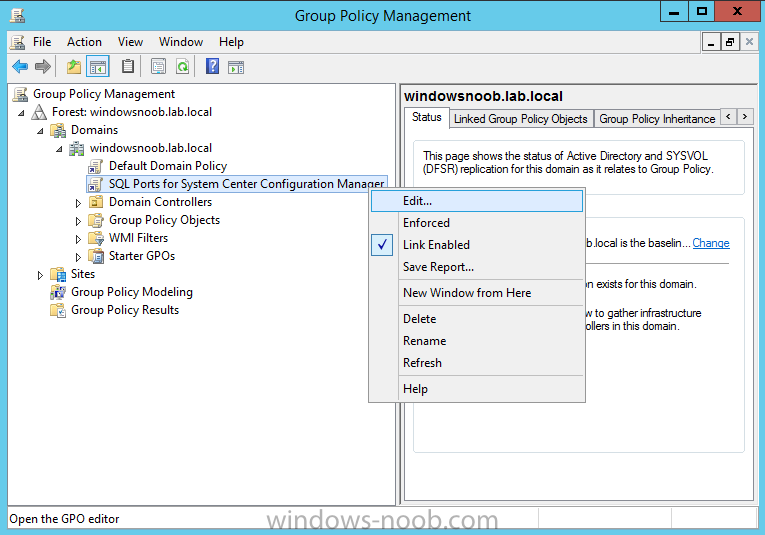

When done, right click on the GPO and choose Edit.

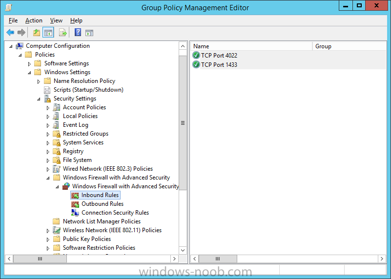

Select Computer Configuration, Policies, Windows Settings, Security Settings, Windows Firewall with Advanced Security and select Inbound Rules, choose New Rule and follow the wizard for opening up TCP port 1433 as per this guide on Technet. Once done, repeat the above for TCP Port 4022.

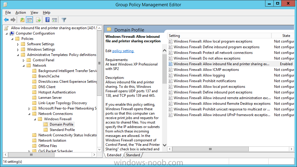

Optional: Once the above is done, and if you intend on using the PowerShell script in Step 2 to create users and to make a user a local admin on the CM01 server, create another GPO called Allow Inbound File and Printer sharing exception which sets Windows Firewall: Allow inbound file and printer sharing exception to Enabled.
This policy is located in Computer Configuration, Administrative Templates, Network, Network Connections, Windows Firewall, Domain Profile.

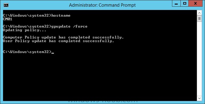

Once done, apply the GPO's by running gpupdate /force on CM01.

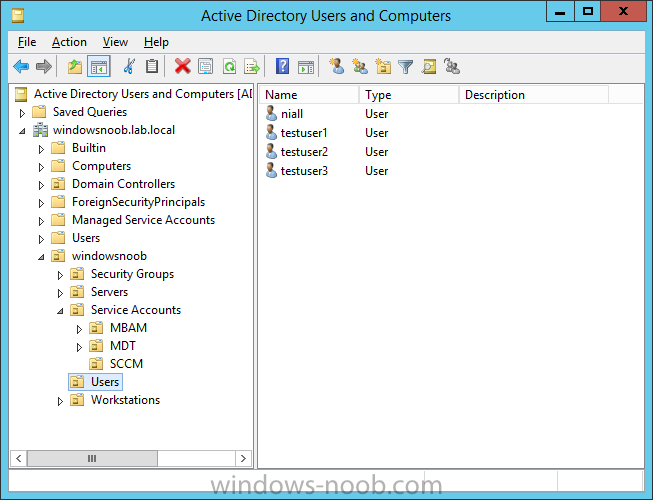

To create users manually, add the following users in AD using Active Directory Users and Computers
* <your user name>, a domain user, this user will become a local administrator on CM01
* Testuser, a domain user
* CM_BA, used for building ConfigMgr created images
* CM_JD, used for joining computers to the domain
* CM_SR used for reporting services.
* CM_CP, a domain user used when installing the Configuration Manager Client for Client Push.
* CM_NAA, a domain user, (Network Access Account) used during OSD
or use the supplied PowerShell script
Create Users Usergroups and OU in AD.zipFetching info...
Download and the unzip the script, run it by opening Windows PowerShell ISE as Administrator on AD1. You may need to edit the script and adjust the variables to your liking for example if you want to change the default password, you may also want to rem out the MDT and MBAM user/groups that are created and change some of the user names within.
After running the PowerShell script in Windows PowerShell ISE you'll see something like the following.
and in Active Directory Users and Groups you can see the OU and structure it created

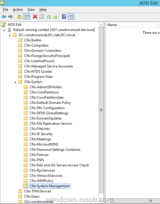

Open ADSI Edit, click on Action, Connect To and click Ok, Double Click on Default Naming Context and the DC= that appears below it. Click on the + and scroll down to CN=System.
Right Click on CN=System and choose New, Object,
choose Container from the options, click Next and enter System Management as the value as shown below

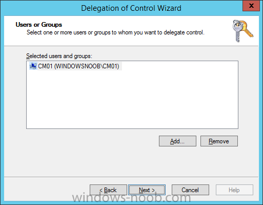

Open Active Directory Users and Computers. Click on view, select Advanced Features. Select the System Management Container, and right click it, choose All Tasks and Delegate Control. When the Welcome to Delegation of Control Wizard appears click next, then click Add. click on Object Types, select Computers.
Type in your Configuration Manager server name (CM01) and click on Check Names, it should resolve.

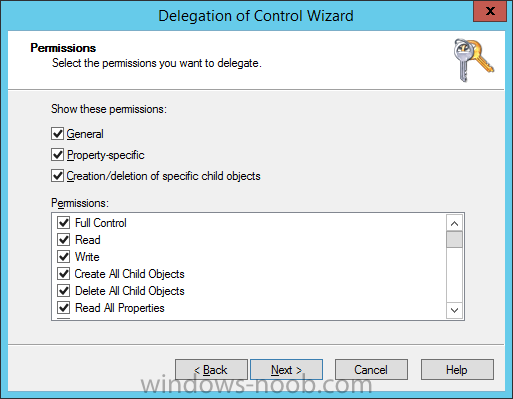

Click Ok, then Next. Choose Create a Custom Task to Delegate, click next, make sure This folder, existing objects in this folder and creation of new objects in this folder is selected.
Click next, select the 3 permissions General, Property-Specific and Creation-deletion of specific child objects are selected then place a check mark in Full Control.

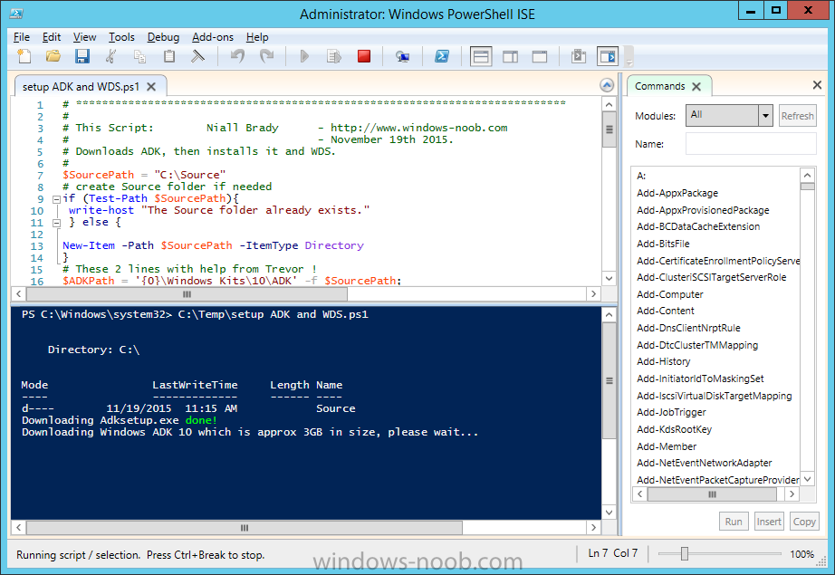

Or run the following PowerShell script to download and install it for you (including installing Windows Deployment Services).
Note: due to issues with Windows ADK 10 for build 1511, i'm using the original Windows 10 ADK in the download script.

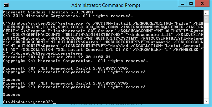

This line below will install SQL Server with the correct collation needed for ConfigMgr to C:\Program Files\Microsoft SQL Server.
If you don't want to use that location you can change it by changing the /INSTANCEDIR in the line listed below in addition, make sure to place your SQL Server 2014 media in D:\ before running the script, if it's on a different drive letter, modify D:\setup.exe accordingly. To start the install, open an administrative cmd prompt on CM01 and change "windowsnoob\niall" to match your domain\username, after you've made the edit, press enter to install SQL Server 2014.
D:\setup.exe /q /ACTION=Install /ERRORREPORTING="False" /FEATURES=SQLENGINE,RS,IS,SSMS,TOOLS,ADV_SSMS,CONN /INSTANCENAME=MSSQLSERVER /INSTANCEDIR="C:\Program Files\Microsoft SQL Server" /SQLSVCACCOUNT="NT AUTHORITY\System" /SQLSYSADMINACCOUNTS="BUILTIN\ADMINISTRATORS" "windowsnoob\niall" /SQLSVCSTARTUPTYPE=Automatic /AGTSVCACCOUNT="NT AUTHORITY\SYSTEM" /AGTSVCSTARTUPTYPE=Automatic /RSSVCACCOUNT="NT AUTHORITY\System" /RSSVCSTARTUPTYPE=Automatic /ISSVCACCOUNT="NT AUTHORITY\System" /ISSVCSTARTUPTYPE=Disabled /ASCOLLATION="Latin1_General_CI_AS" /SQLCOLLATION="SQL_Latin1_General_CP1_CI_AS" /TCPENABLED="1" /NPENABLED="1" /IAcceptSQLServerLicenseTerms
For a list of options for installing SQL Server 2014, see this page on Technet: https://technet.microsoft.com/en-US/library/dd239405%28v=sql.120%29.aspx
Once installed, you should see success messages like below, if not, troubleshoot the error and/or review your command line for typos.

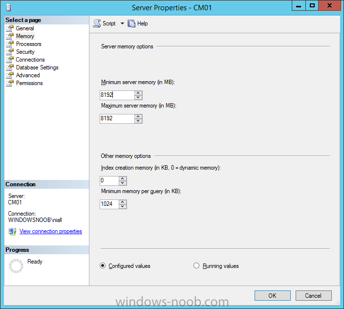

Step 8. SQL Memory Configuration.
Depending on your memory configuration and server setup, you may also want to configure SQL memory limits as per the following guidance prior to installing ConfigMgr otherwise you'll get warnings when you run the Server Readiness checks.
  • Configuration Manager requires SQL Server to reserve a minimum of 8 gigabytes (GB) of memory for the central administration site and primary site and a minimum of 4 gigabytes (GB) for the secondary site. This memory is reserved by using the Minimum server memory setting under Server Memory Options and is configured by using SQL Server Management Studio. For more information about how to set a fixed amount of memory, see here.
  • If your SQL Server is configured for unlimited memory usage, you should configure SQL Server memory to have a maximum limit.
Based on the above recommendations i've configured the SQL Server memory for this standalone primary in my lab as follows:

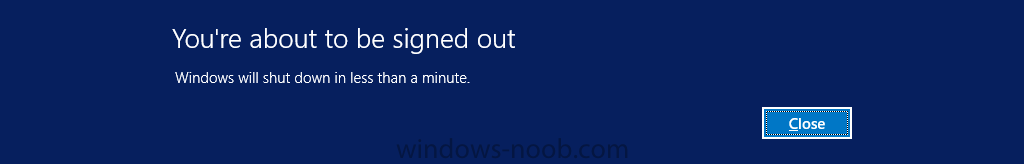

Step 9. Restart the Server
open an administrative command prompt and issue the following
shutdown /r

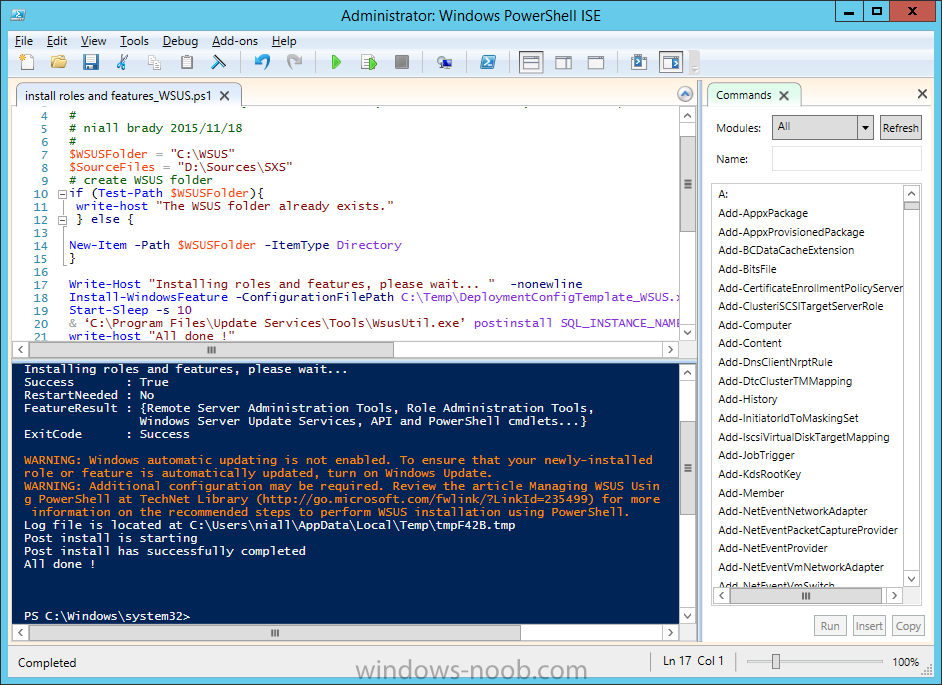

Now that SQL server is installed, we can utilise that for the WSUS database. To install WSUS and configure it to use the database created above, do as follows:
browse to the location where you extracted the scripts, C:\Temp
Start Windows PowerShell ISE as administrator, then run the install roles and features_WSUS.ps1 script.

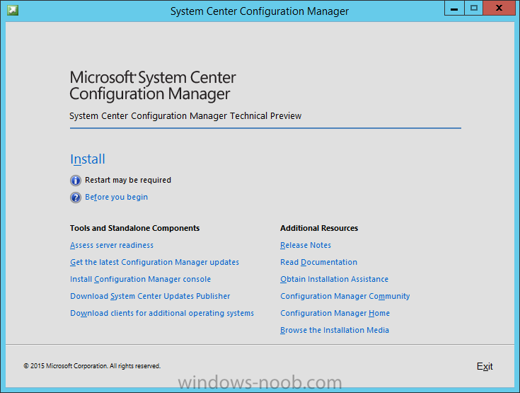

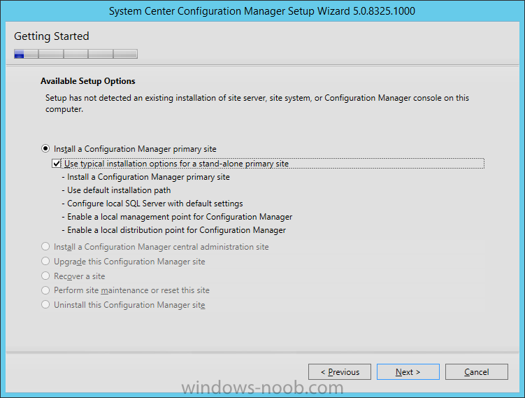

Browse to C:\SC_Configmgr_SCEP_TechPreview and click on Splash.HTA
click on Install and then click on Next
place a checkmark in Use typical installation options for a stand-alone primary site and click next

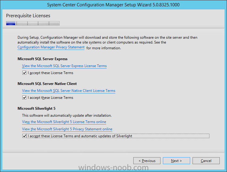

accept the two pages of EULAs

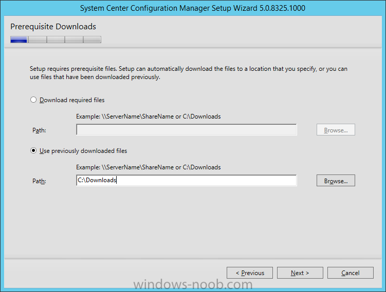

select Use Previously downloaded files and specify C:\Downloads

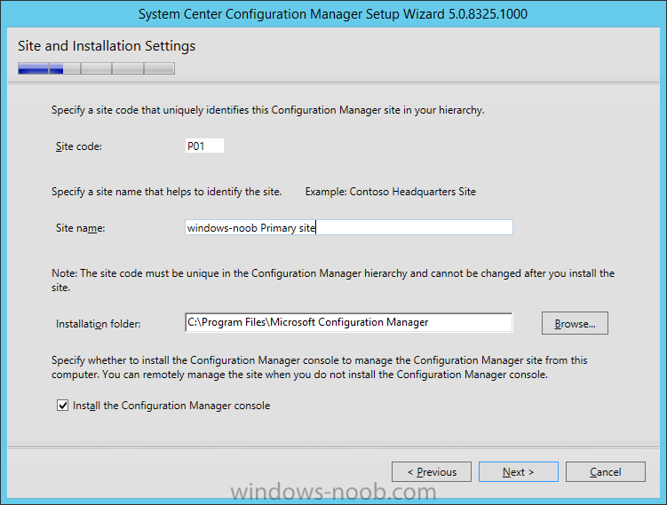

fill in your desired site code and name/path.

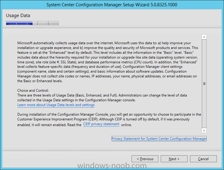

review your CEIP options

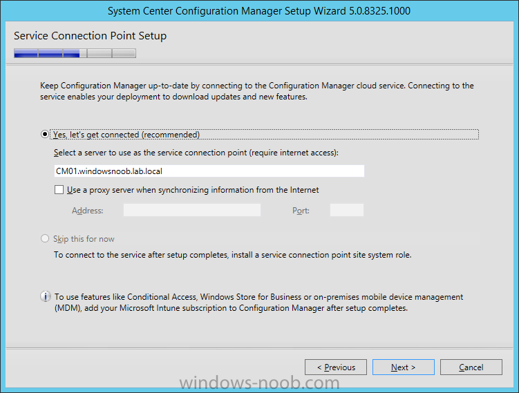

and select your Service Connection Point settings (hard coded for now), this is the setting which allows you to decide to keep up to date with Configmgr releases, by being notified about them, or not. You can change the choice later in the console.

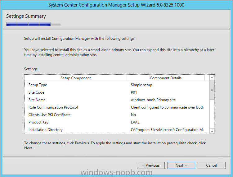

review the Settings Summary

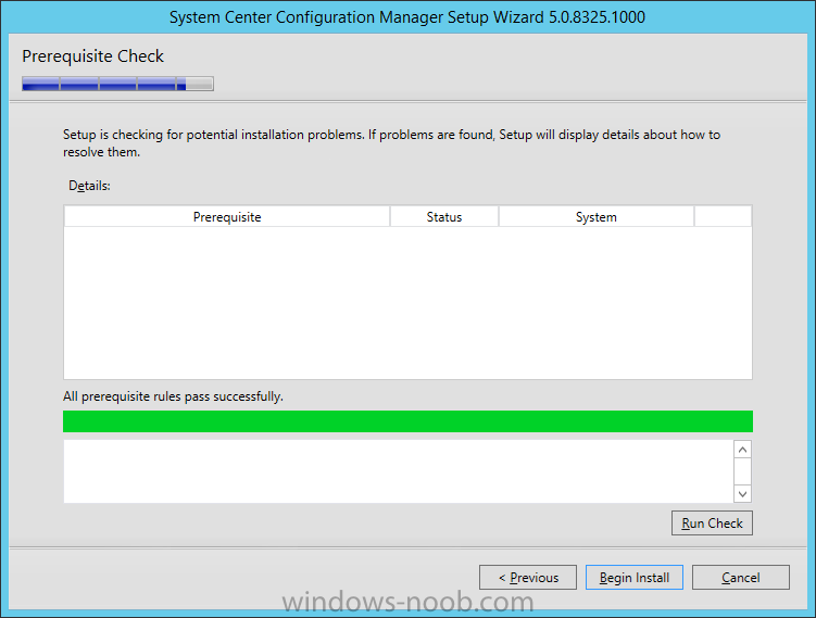

and enjoy the fact that you are following a windows-noob.com guide, so no errors or warnings are reported.

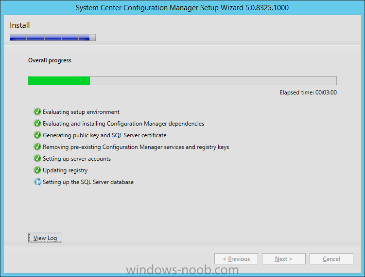

Click on Begin Install to install.
off it goes...

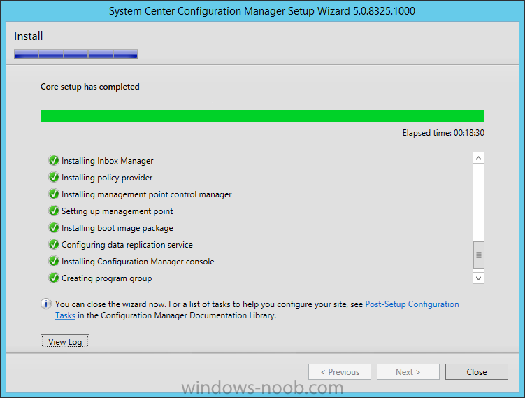

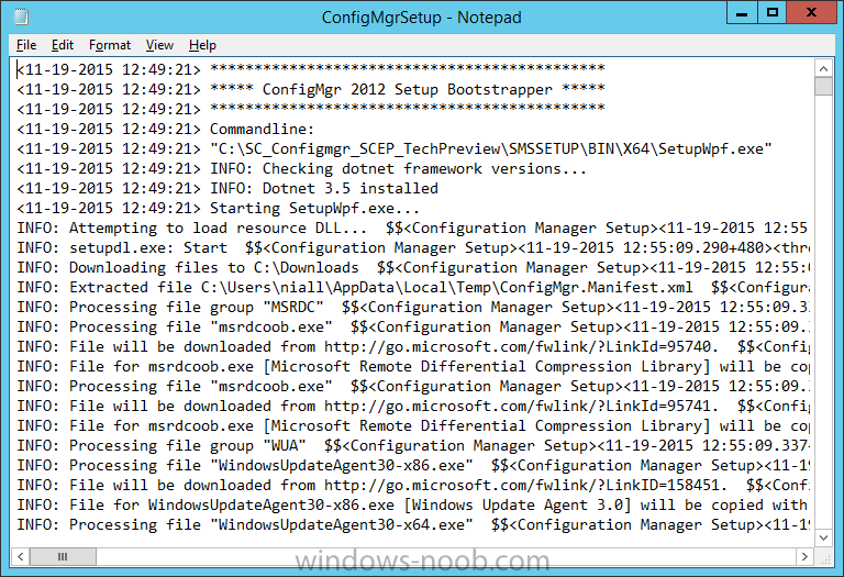

click on View Log to see what's being logged about the install
and after a certain period, you are done !

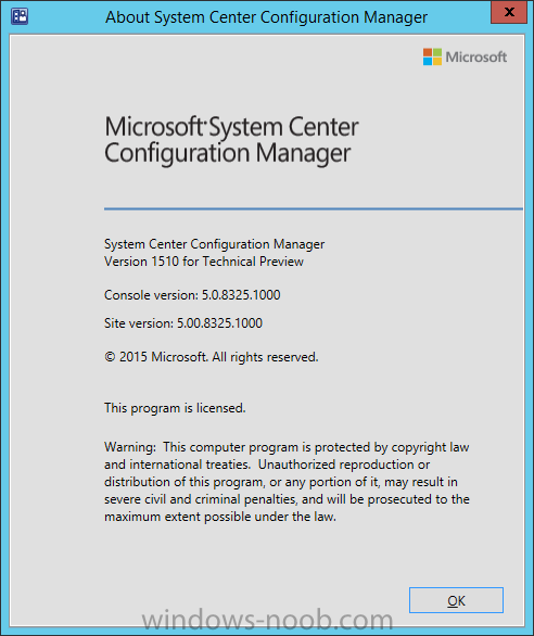

Step 16. Open the Console
Now that everything is installed, open the Configuration Manager console, click on Help, About, here's the version.
