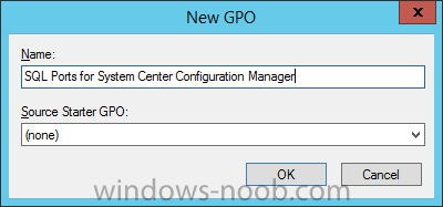

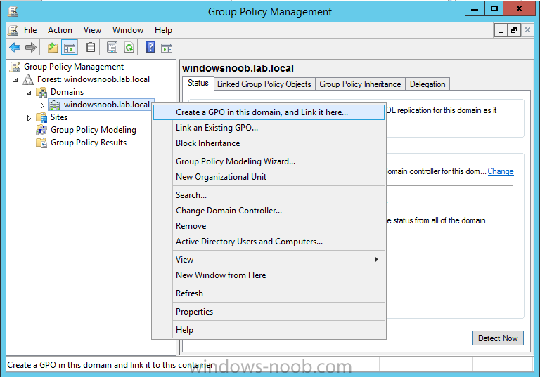

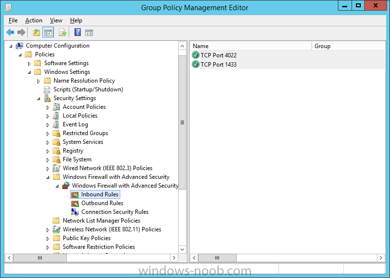

To allow SQL to replicate data, open the following TCP ports in the Configuration Manager firewall, 1433, 4022. You can do this by targetting your ConfigMgr servers with a GPO. To create the GPO do as follows. Start the Group Policy Management tool (GPMC.MSC) and create a new GPO.
Note: In the preceding screenshot I link the GPO to the domain GPO however you should consider creating an OU specifically for your Configuration Manager servers and target this GPO only to that OU (your Configuration Manager servers require this GPO for SQL replication).

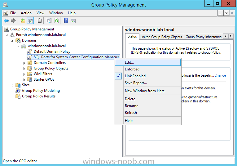

Give the GPO a name such as SQL Ports for System Center Configuration Manager.
When done, right click on the GPO and choose Edit.
Select Computer Configuration, Policies, Windows Settings, Security Settings, Windows Firewall with Advanced Security and select Inbound Rules, choose New Rule and follow the wizard for opening up TCP port 1433 as per this guide on Technet. Once done, repeat the above for TCP Port 4022.

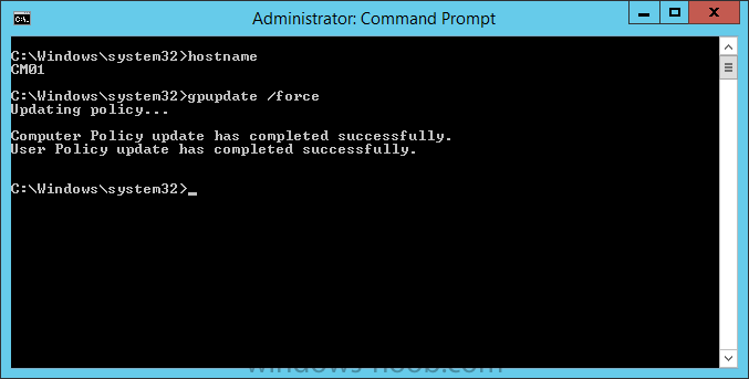

Once done, apply the GPO's by running gpupdate /force on CM01.

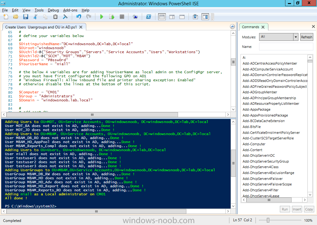

To create users automatically, use the Create Users Usergroups and OU in AD.ps1 PowerShell script
Copy the script to AD1, start Windows PowerShell ISE as Administrator and open the Create Users Usergroups and OU in AD.ps1 script. Edit the variables as desired before running.
Note: You need to edit the script and adjust the variables to your liking, for example if you want to change the default password. You may also want to rem out the MDT and MBAM user/groups that are created and change some of the user names within the script.
After running the PowerShell script in Windows PowerShell ISE you'll see something like the following.
and in Active Directory Users and Groups you can see the OU and structure it has created.

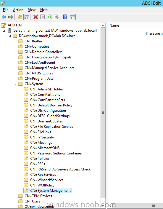

Step 3. Create the System Management Container
Note: Perform the following on the Active Directory Domain Controller server (AD1) as Local Administrator
Open ADSI Edit, click on Action, Connect To and click Ok, Double Click on Default Naming Context and the DC= that appears below it. Click on the + and scroll down to CN=System.
Right Click on CN=System and choose New, Object,
choose Container from the options, click Next and enter System Management as the value as shown below

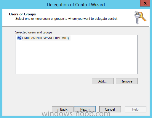

Open Active Directory Users and Computers. Click on view, select Advanced Features. Select the System Management Container, and right click it, choose All Tasks and Delegate Control. When the Welcome to Delegation of Control Wizard appears click next, then click Add. click on Object Types, select Computers.
Type in your Configuration Manager server name (CM01) and click on Check Names, it should resolve.

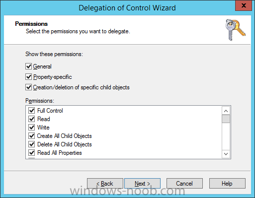

Click Ok, then Next. Choose Create a Custom Task to Delegate, click next, make sure This folder, existing objects in this folder and creation of new objects in this folder is selected.
Click next, select the 3 permissions General, Property-Specific and Creation-deletion of specific child objects are selected then place a check mark in Full Control.

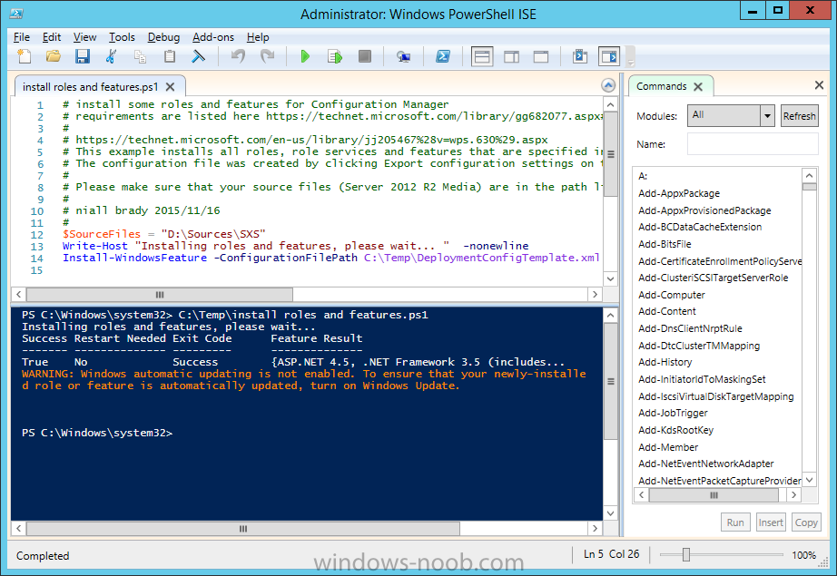

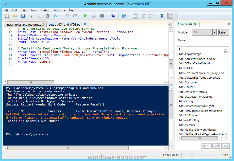

Step 5. Install Roles and Features on CM01
Note: Perform the following on the Configuration Manager server (CM01) as a Local Administrator
To support the various features in System Center Configuration Manager, the setup wizard requires some Server Roles and Features pre-installed on CM01, so let's go ahead and install them. On CM01, login as the username you added to the Local Administrators group and navigate to C:\Temp. The XML files within the Scripts Used in This Guide.zip were created using the Export Configuration File option in Server Manager after manually installing roles and features and the accompanying PowerShell script simply installs it.
Note: Make sure your Server 2012R2 media is in the drive specified in the script or edit the script to point to the location of the media.
To install the roles and features needed, start Windows Powershell ISE as Administrator and run the install roles and features.ps1 script.
Step 6. Download and install Windows ADK 10
The ConfigMgr prerequisite checker will check for various things, including ADK components such as USMT and Windows Preinstallation Environment (amongst others), therefore you need to install Windows ADK on your server. To do so, either download ADKsetup from here and manually install it or run the setup ADK and WDS.ps1 PowerShell script to download and install the correct components for you. This script not only downloads the components needed, it's also installs ADK 10 and then installs Windows Deployment Services. The setup ADK and WDS.ps1 PowerShell script is available in the Scripts Used in this Guide zip file.
Note: due to issues with Windows ADK 10 for build 1511,I'm using the original Windows 10 ADK in the download script.
Update: ADK 1511 has got a hotfix (March 2nd, 2016) to fix the previous issues, please read the updated blog about that here.
To download and then install Windows ADK 10 with the components needed, start Windows Powershell ISE as Administrator and run the setup ADK and WDS.ps1 script.

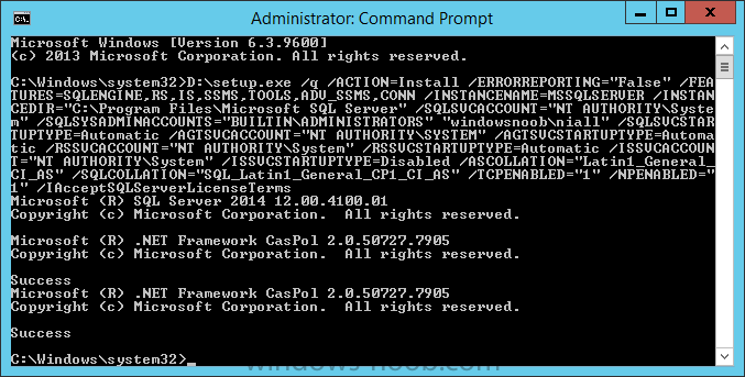

Before you install the Configuration Manager you need SQL installed, both SQL Server 2012 and SQL Server 2014 are supported however you will use the latest release in this guide which is SQL 2014. I used the following release from MSDN for this guide, however you should use Volume License media in production:-
  • en_sql_server_2014_standard_edition_with_service_pack_1_x64_dvd_6669998.iso
The command line below will install SQL Server with the correct collation needed for ConfigMgr to the following location: C:\Program Files\Microsoft SQL Server. If you don't want to use that location you can change it by modifying the /INSTANCEDIR reference. In addition, make sure to place your SQL Server 2014 media in the appropriate drive before running the script, if it's on a different drive letter, modify D:\setup.exe accordingly.
To start the install, open an administrative cmd prompt on CM01 and change "windowsnoob\niall" to match your domain\username, after you've made the edit, press enter to install SQL Server 2014.
D:\setup.exe /q /ACTION=Install /ERRORREPORTING="False" /FEATURES=SQLENGINE,RS,IS,SSMS,TOOLS,ADV_SSMS,CONN /INSTANCENAME=MSSQLSERVER /INSTANCEDIR="C:\Program Files\Microsoft SQL Server" /SQLSVCACCOUNT="NT AUTHORITY\System" /SQLSYSADMINACCOUNTS="BUILTIN\ADMINISTRATORS" "windowsnoob\niall" /SQLSVCSTARTUPTYPE=Automatic /AGTSVCACCOUNT="NT AUTHORITY\SYSTEM" /AGTSVCSTARTUPTYPE=Automatic /RSSVCACCOUNT="NT AUTHORITY\System" /RSSVCSTARTUPTYPE=Automatic /ISSVCACCOUNT="NT AUTHORITY\System" /ISSVCSTARTUPTYPE=Disabled /ASCOLLATION="Latin1_General_CI_AS" /SQLCOLLATION="SQL_Latin1_General_CP1_CI_AS" /TCPENABLED="1" /NPENABLED="1" /IAcceptSQLServerLicenseTerms
For a list of options for installing SQL Server 2014, see this page on Technet: https://technet.micr...v=sql.120).aspx
Once installed, you should see success messages like below, if not, troubleshoot the errors and/or review your command line for typos.

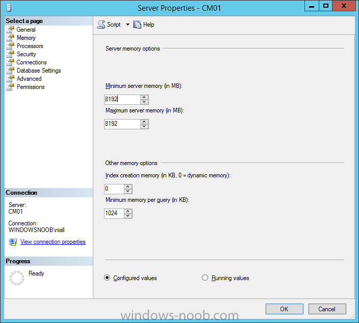

Step 8. SQL Memory Configuration
Depending on your memory configuration and server setup, you may also want to configure SQL memory limits as per the following guidance prior to installing ConfigMgr otherwise you'll get warnings in the Prerequisite checker when it runs the Server Readiness checks.
  • Configuration Manager requires SQL Server to reserve a minimum of 8 gigabytes (GB) of memory for the central administration site and primary site and a minimum of 4 gigabytes (GB) for the secondary site. This memory is reserved by using the Minimum server memory setting under Server Memory Options and is configured by using SQL Server Management Studio. For more information about how to set a fixed amount of memory, see here.
  • If your SQL Server is configured for unlimited memory usage, you should configure SQL Server memory to have a maximum limit.
Based on this guidance I've configured the SQL Server memory for this standalone primary as follows:

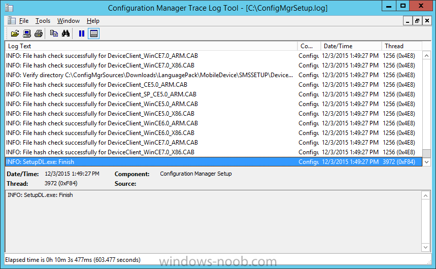

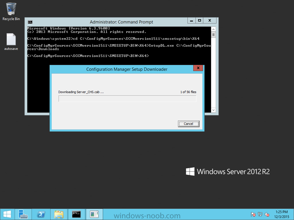

Step 13. Download the ConfigMgr Prerequisites

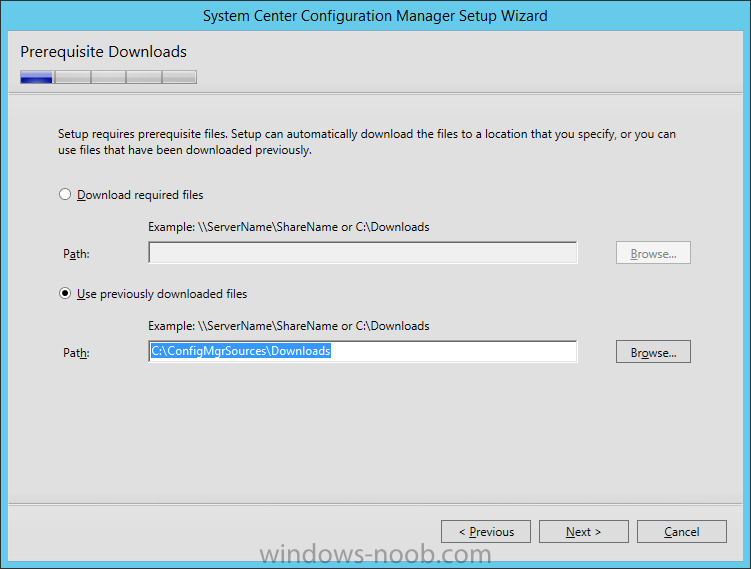

You can download the prerequisites during ConfigMgr setup or in advance. As you'll probably want to install more than one copy of ConfigMgr (one lab, one production) it's nice to have the prerequisites downloaded in advance. To do that, open a command prompt with administrative permissions and navigate to the following folder:
C:\ConfigMgrSources\SCCMversion1511\smssetup\bin\X64
Run the following line
SetupDL.exe C:\ConfigMgrSources\Downloads

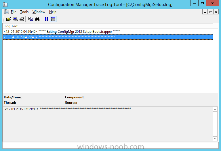

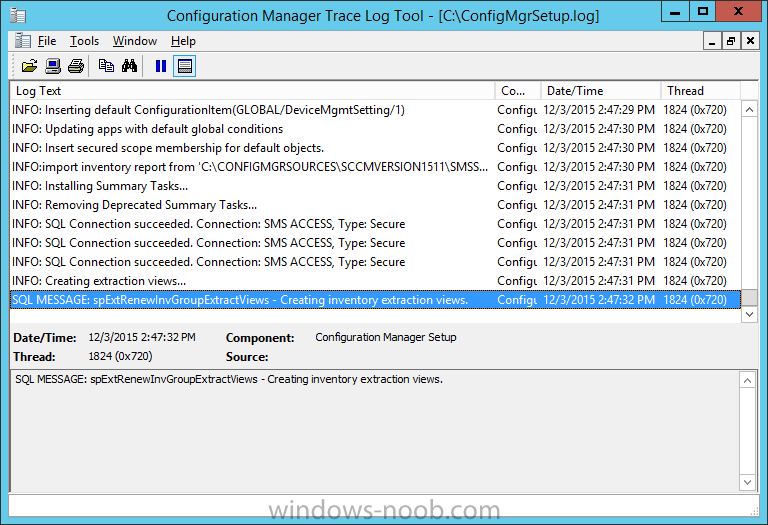

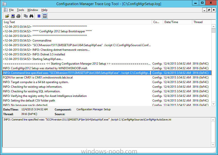

Tip: Browse to C:\ConfigMgrSources\SCCMversion1511\SMSSETUP\TOOLS and double click on CMTrace.exe, answer Yes to the default logging question. Then, using Windows File Explorer, browse to C:\ and double click on ConfigMgrSetup.log which will open the log file in CMTrace. This will allow you to view any errors or problems with the download of the prerequisites in real time.

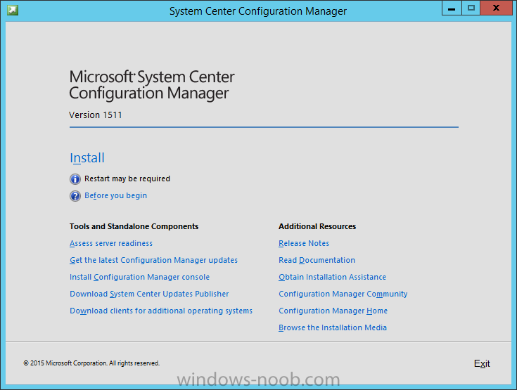

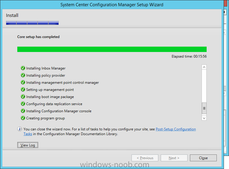

Step 15. Install Configuration Manager version 1511 manually

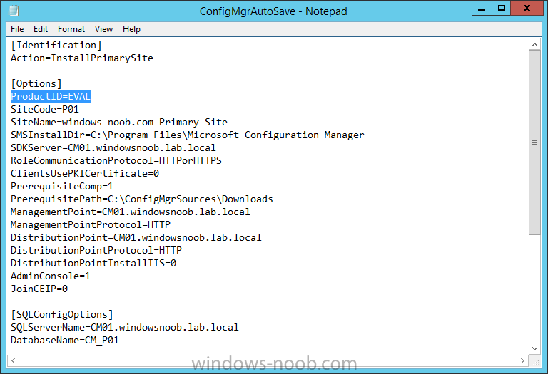

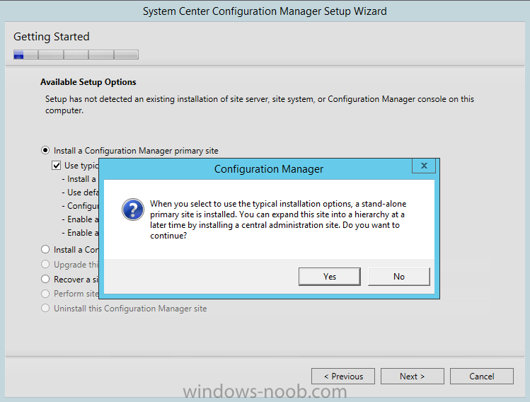

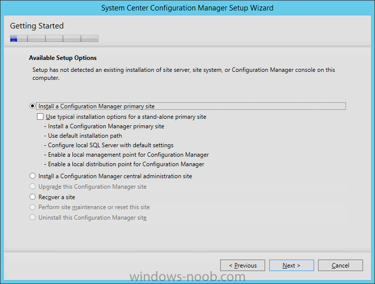

There are two ways to install ConfigMgr, manually using the ConfigMgr setup wizard or unattended. To install it manually use the settings below To do an unattended install jump to the next step.
Browse to C:\ConfigMgrSources\SCCMversion1511 and click on Splash.HTA, notice the version number is clearly listed !
click on Install and then click on Next

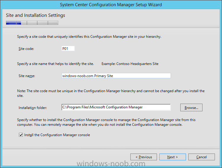

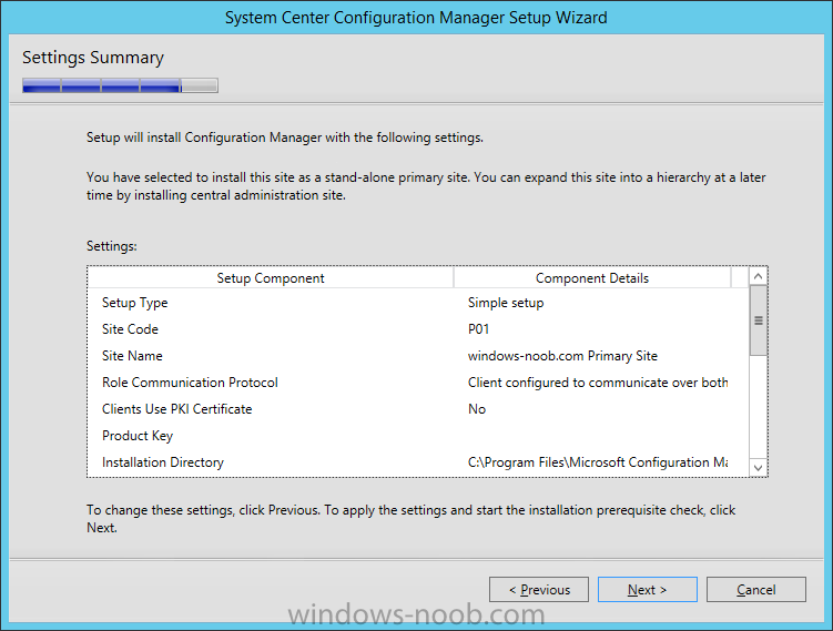

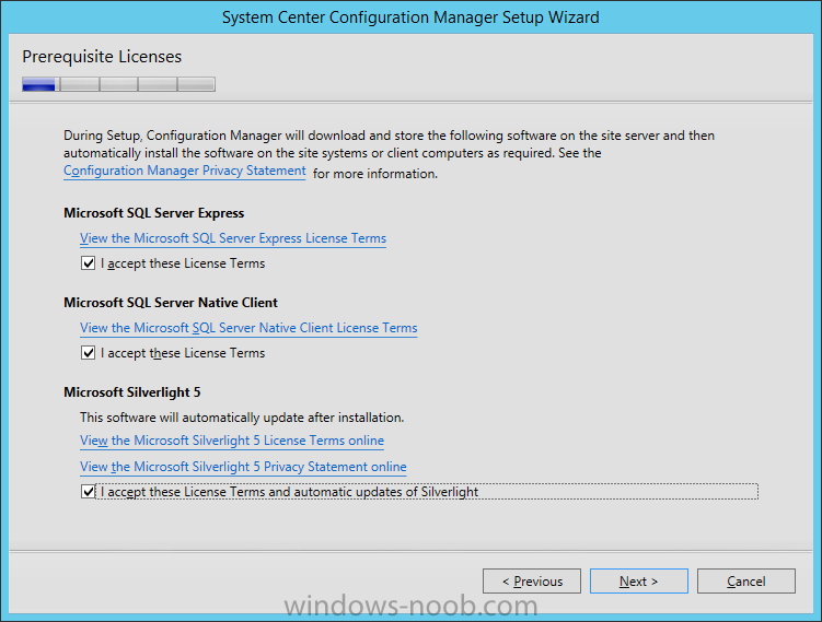

Note: In this release, you now have the option to install a Standalone Primary (recommended) or a CAS. If running setup on an already installed site (such as Configuration Manager 2012 R2) you will be offered the Upgrade option.
Select the option to Use typical installation options for a stand-alone primary site and click on Next. You'll be prompted with a note, read it before clicking on Yes.
Next you get to install the licensed or evaluation version (180 days) of the product, choose your version and click on Next.
read the EULA and agree to the terms to continue

accept the license terms for SQL server express and Silverlight
select previously downloaded files and provide the following path C:\ConfigMgrSources\Downloads before clicking on Next
fill in your Site Code, Site name, Installation Folder and then click Next
Note: Change the Site Code, Site Name and Installation Folder to values that suit your environment, you can't change them later so think before clicking next.

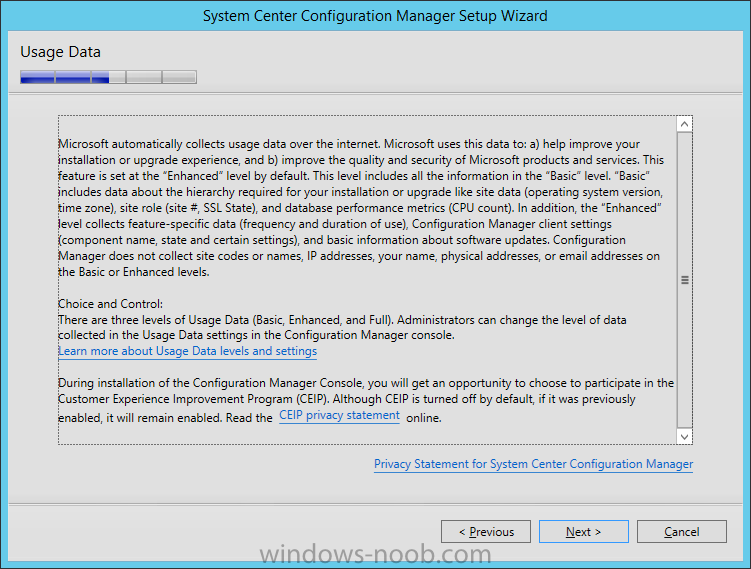

review the Usage Data screen, this gives you info about what data Microsoft collects and how you can change the User Data levels and settings choice at a later stage from within the ConfigMgr Console.

finally, review your Settings Summary
and if you followed this guide correctly all prerequisite rules pass successfully.

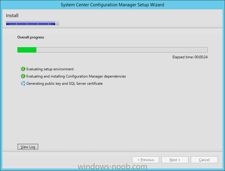

Click on Begin Install to start the installation
and click on View Log in the lower left corner (or use Windows File Explorer and open C:\ConfigMgrSetup.log) to bring up the log file in CMTrace so you can see the installation progress (or issues encountered) in real time....perhaps now is a good time for a coffee or some other suitable beverage ;-)
and after a while you are done !
Click on close.

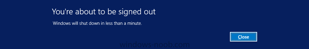

You should now restart the Configuration Manager server via an administrative command prompt, enter the following:
shutdown /r

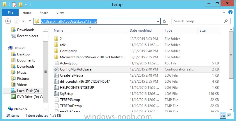

To install ConfigMgr automated (unattended) you need to generate or use a previously created ini file called ConfigMgrAutoSave.ini. The easiest way to generate one is to go through a manual installation as shown in the step above and capture the file after everything is complete. The file will be stored in your %temp% profile as shown below:
Below is a sample ConfigMgrAutoSave.ini file created from the above installation choices I made, I've removed the ProductID and SysCenterID values however.
[Identification]
Action=InstallPrimarySite
[Options]
ProductID=EVAL
SiteCode=P01
SiteName=windows-noob.com Primary Site
SMSInstallDir=C:\Program Files\Microsoft Configuration Manager
SDKServer=CM01.windowsnoob.lab.local
RoleCommunicationProtocol=HTTPorHTTPS
ClientsUsePKICertificate=0
PrerequisiteComp=1
PrerequisitePath=C:\ConfigMgrSources\Downloads
ManagementPoint=CM01.windowsnoob.lab.local
ManagementPointProtocol=HTTP
DistributionPoint=CM01.windowsnoob.lab.local
DistributionPointProtocol=HTTP
DistributionPointInstallIIS=0
AdminConsole=1
JoinCEIP=0
[SQLConfigOptions]
SQLServerName=CM01.windowsnoob.lab.local
DatabaseName=CM_P01
SQLSSBPort=4022
[CloudConnectorOptions]
CloudConnector=1
CloudConnectorServer=CM01.windowsnoob.lab.local
UseProxy=0
ProxyName=
ProxyPort=
[SystemCenterOptions]
SysCenterId=
[HierarchyExpansionOption]
You can find a copy of the above file in the Scripts Used in This Guide.zip file.
Note: You will need to edit this file and replace the values with those that work in your environment. For example, to change the ProductId open the file in notepad, locate the line that reads ProductID= and either enter your ConfigMgr Product Key or use the evaluation version of ConfigMgr by entering the word EVAL as shown below.
To start an unattended install using the ini file do as follows. Save any changes you have made to the file, then copy the file to C:\ConfigMgrSources. Once copied, start the unattended install by running the following command:
SCCMversion1511\SMSSETUP\bin\X64\Setup.exe /script C:\ConfigMgrSources\ConfigMgrAutoSave.ini
as the install is unattended you'll need to review the ConfigMgrSetup.log file stored in the root of C: using CMTrace to get a real time status of the installation.
and after a period of time if all went well you'll see this in the log file
However you should open the main log (more than likely renamed to ConfigMgrSetup.LO_) file to verify there were no issues during setup.

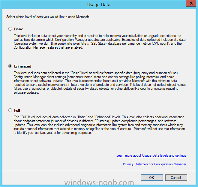

Step 18. Configure Usage Data settings
Earlier in this guide you saw a Usage Data information screen with no configurable options. To configure what Usage Data is sent to Microsoft do as follows. In the ConfigMgr Console, click on the white downward pointing arrow in the top left, and select Usage Data from the options available.
there are three levels shown, Basic, Enhanced (default) and Full. Make your choice and click on OK
You can click on the two clickable links provided to get more info about what these Usage Data settings and levels mean.

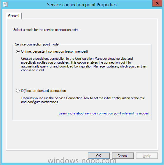

Step 19. Configure Service Connection Point
During setup you have the choice of installing the Service Connection Point role (or skipping it). You can configure this by selecting Administration, Servers and Site System roles, select your Primary site and then select the Service Connection Point role from the roles listed as installed on the server. The options available are Online or Offline. If you do choose offline then you'll have to use the Service Connection Point tool to manually setup the role and configure notifications.

If you don't have the Windows Firewall enabled, you don't need to create those settings in a GPO, or locally. Just make sure that the required ports are open on the network-level.
Only the ConfigMgr site server needs permissions to the System Management container. The database server doesn't have to write anything in that container.
