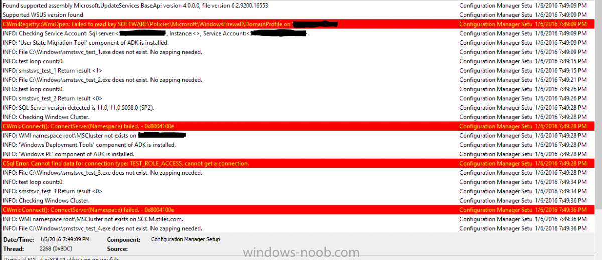

Config_Mgr_noob Posted January 7, 2016 Report post Posted January 7, 2016 Hi All, I am currently attempting to upgrade my SCCM 2012 R2 to R2 SP1. During the prereq scan I receive 2 warnings referring to SQL Server security mode and SQL Server process memory allocation along with a 3rd warning for Verify site server permissions to publish to Active Directory. That is all that appears in the prereq details windows. However, within the ConfigMgrSetup.log file I see several errors that are referring "WARNING: Failed to initialize COM to get SDK Providers. It might already be initialized. return code: 80010106." as well as several errors referring to CWmi Namespace. Can anyone shed light on the screenshot below? Should I continue the upgrade and disregard the errors or is this a concern? Thanks in advance. Quote Share this post Link to post Share on other sites More sharing options...

Config_Mgr_noob Posted January 7, 2016 Report post Posted January 7, 2016 Thank you ZeZe for the link and info regarding AD and SQL. I have to follow up with my admin to verify permissions to the container; I'm sure it already has full perm but doesn't hurt to check. However, what you think about the errors I am receiving within the ConfigMgrSetup.log? Anything I should worry about? I have already attempted to upgrade this box to SP1 before but received a huge error and SCCM was not functioning. I had to submit a Microsoft CSS call to recover my site and rather not go through all that again. Quote Share this post Link to post Share on other sites More sharing options...
ZeZe Posted January 7, 2016 Report post Posted January 7, 2016 If the permissions are not there, the wizard will always tell you that something is missing (warning as you already noticed). Make sure also that Active directory is replicated... Regarding the log, it doesn't tell me much but in general looks like a connection problem? Could be related with the firewall policies? If you have a firewall turned on, make sure the SQL ports are "allowed". Quote Share this post Link to post Share on other sites More sharing options...
