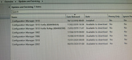

Great guide,  but have 1 question,  after importing all i can see is that downloads state is set to "Available to download". Would you have any suggestion as to why this would not fully download?  SCCM version 1810 trying to patch to 2002
