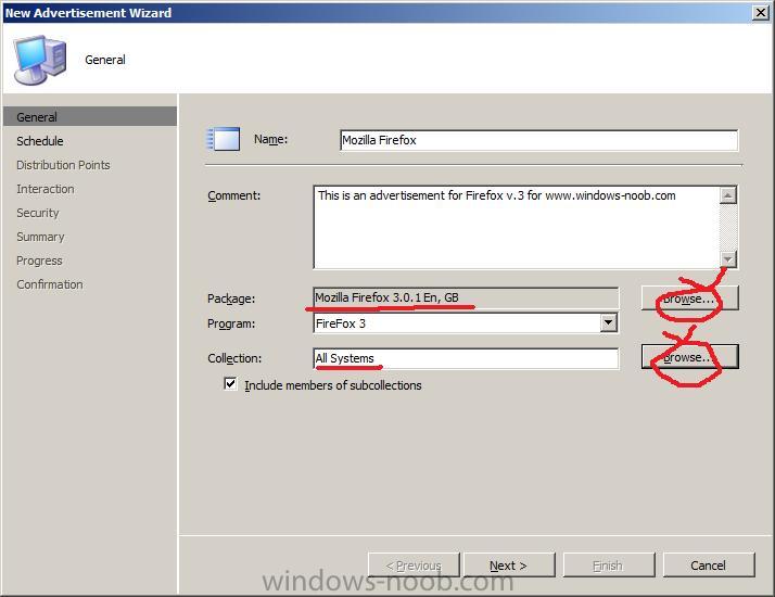

to continue on what Peter said, any package can have a program (or programs, or even none at all)
when it comes to advertising a package you get the choice of what program to run, so you could create a separate advertisement for the same package which uses a different program, and the different program is simply the silent install with the relevant uninstall switches

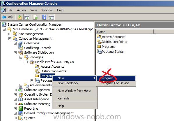

if you look at this screenshot
you can imagine a new advertisement and the drop down menu for Program could contain your newly created Uninstall program for Firefox
