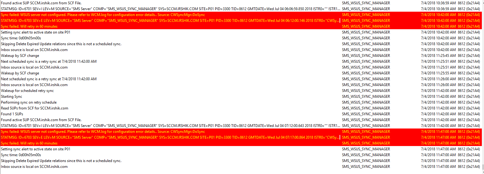

Hi. Thanks for your perfect guides. My LAB is Based on Server 2016. and SCCM is 1802. i have problem with Software update . i have two WSUS , one of them install at the SCCM server (Because i thought maybe  its require  ) .but in GPedit.msc i changed wsus path to  my main WSUS server . when i check wsyncmgr.log  it show everything synced complete and there was no problem(Synced 100%). but i can't see any update in All Software Update .  then i run ( Add SUP role.zip ) Script, and it's done complete without any problem.i checked again wsyncmgr.log and i face with that error (In the picture) .  so i check my Software update and there was nothing again.. so please tell me what should i have to do ? :) .
another question : do we need  WSUS Service On other server  or we need just Install WSUS role in SCCM Server??? ( now i have both of them )
