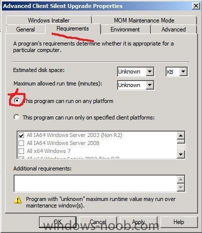

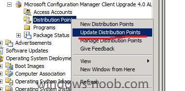

* I also have to change/update my boot images - yup if they have any drivers or customisations added/or they are MDT
* Set the new client install upgrade in each task sequence - just upgrade your current client package
* reinstall every sccm client to sp2 - use this post
