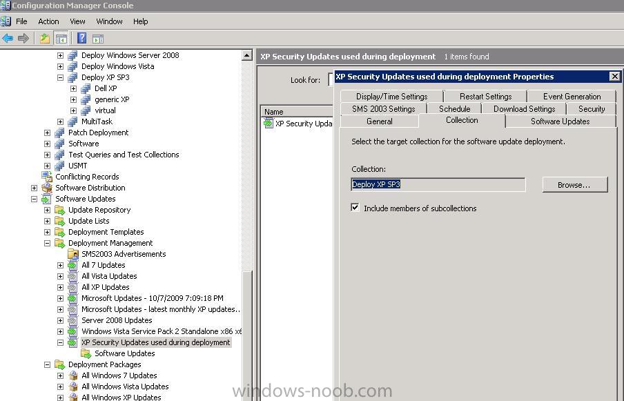

0 jeaostro Posted January 27, 2010 Report post Posted January 27, 2010 when deploying updates within a OSD I create a Deployment Management task for just that purpose, with for example Windows XP updates, I also name the deployment management task to be descriptive of what it's doing I then target that deployment management task to a collection used for deployments look at this screenshot for ideas Are there any guides for knowing what updates can not be installed during OS deployment? Tried adding more updates today, and the installation fail again(now there are 0 .Net patches), but there are some for Outlook Express, media player, active x, messenger, etc. Thanks Quote Share this post Link to post Share on other sites More sharing options...
