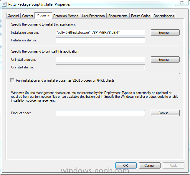

Drekko Posted January 29, 2016 Report post Posted January 29, 2016 Just an update I created an application and chose manual install script, just put the .exe installer file with the extensions and it seemed to install silently with no user-interaction via software center But I would still like to know why my install.bat did not want to work with those switches via network path for future... Quote Share this post Link to post Share on other sites More sharing options...
