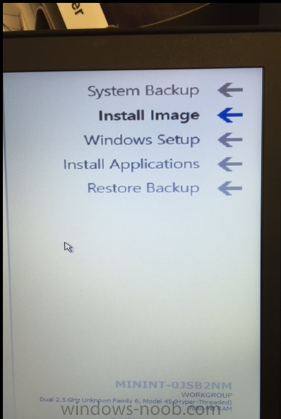

I am trying to image to a laptop in SCCM. It all of the way to the 'Install Image' of the process and it fails.

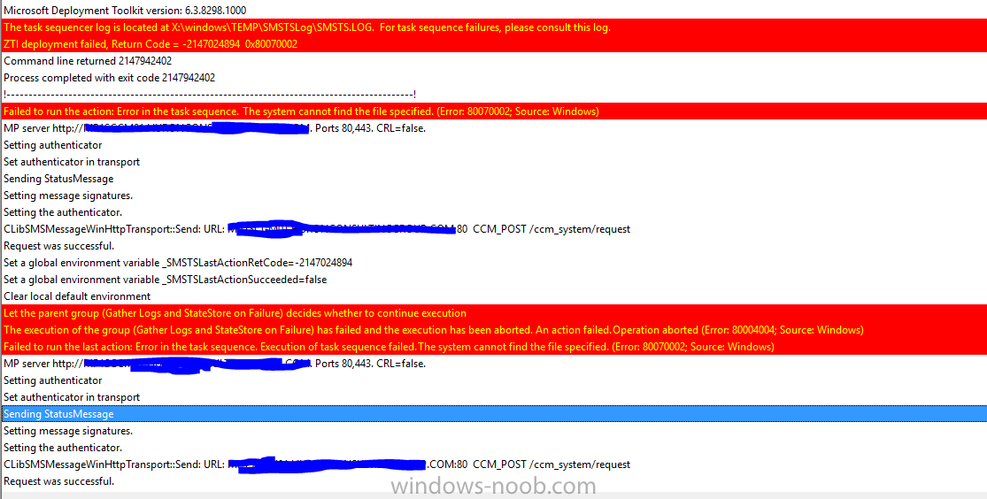

During this time I had the smsts.log just to see where it exactly where it stops. As you can see in the screen shot it halts at "ZTI Deployment failed, Return Code = - 2147024894 0x80070002". Also, below is a little list other info that might be useful.

I attached a pic of the point in which it fails in the log and also the status page
Thanks in advance
  On 2/12/2016 at 7:02 AM, ZeZe said:
Are the MDT packages and settings distributed?
Yes. I did distribute to the DPs. I am going to updates the DP and try again.
