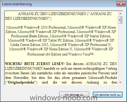

Are you selecting MS updates too in the Update Retriever because these updates cannot be used as they need manual input. I remember that I had a driver issue, I think it was Intel Pro nic drivers that rebooted the computer when the TS was still running.
