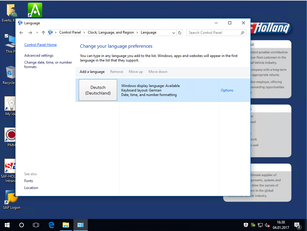

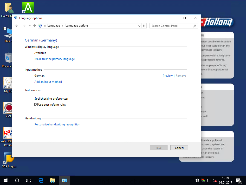

I actually want the OSDUILanguage to be nl-nl and I want the English language pack to be installed as well by default. I have a hard time translating your suggestions to a working TS :)
I added the following steps to my TS
Using these dynamic variables
With this OSDUILanguageFallback
And this LanguageValue
The package contains only the en-us language pack for Windows 10 1607. After the TS I end up with a OS in Dutch with English as an extra language, but the Dutch language choice is missing and the region is set to the United States (Verenigde Staten) but should be The Netherlands (Nederland). English is also the default language. The deployment Collection has a RegionValue of English.

So... I think I am stil doing something wrong here, just no idea what is needed to fix it. I don't want just an English version of Windows 10 or just a Dutch version. I want it to be Dutch by default and under languages I want the English language already installed as an extra language option. :huh:
  On 12/13/2016 at 3:39 PM, anyweb said:
if you want it dutch by default then install using the dutch media and add the english language pack as an add on
We do use the dutch media to install. What is the best way to add the english language as a add-on and have it present by default for all users? audit mode during the reference image? dism in the task sequence? Installation always seems to work, but it doesn't show after logging on :D
