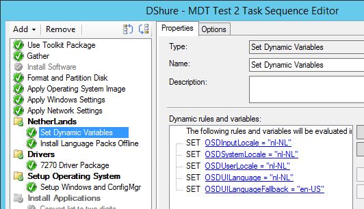

Read your logs Fella's.
Using the red highlighted line as a starting point, as I looked up several lines the answer was in front of me the whole time: Input Error: Can not find script file "C:\_SMSTaskSequence\WDPackage\Scripts\ZTIPatches.wsf".
in my T.S. you see I have the MDT toolkit and gather BEFORE the PARTITION & FORMAT step. not smart unless I add those steps again after the Partition & Format step.
Now my Language pack installs. All that's left to figure out is why these do NOT get set: Input Method and Display language. The System Locale, Format and Location settings DO get set.
