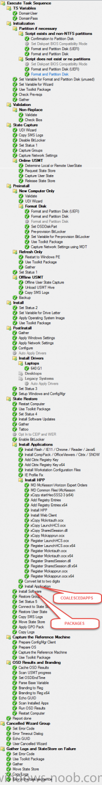

BzowK Posted May 16, 2016 Report post Posted May 16, 2016 Thanks for the reply - I've got to get this working today if at all possible so appreciate the help! Attached is a screenshot I compiled of my current TS. Due to time constrants, much of it it basically MDT's default client UDI TS. A few notes are also below... Notes Please remember, it's not just that UDI selected applications are not installing but NO applications are installing including ones hard-coded in TS Upon TS completion, all drivers are successfully installed - Testing in a Hyper-V VM COALESCEDAPPS & PACKAGES variable steps are labeled as such The Two steps under the "Install Applications" group are "Install Application" steps which have no conditions - None of these install The two Citrix Registry steps below the two above are "Install Package" steps which are successful upon TS completion The "Install HPP" group is successful The "Convert list to two digits" step executes the below string cscript.exe "%deployroot%\scripts\ZTICoalesce.wsf" /CoalescePattern:Applications /CoalesceTarget:CoalescedApps /CoalesceDigits:2 OSD UDI Task Sequence PS: Drivers for additional models will be added later if wondering Thanks guys! Quote Share this post Link to post Share on other sites More sharing options...
BzowK Posted May 17, 2016 Report post Posted May 17, 2016 Hey Guys - Any suggestions on this? I'm at a loss, but must find a solution. I considered repacking everything as Packages, but not only would that take forever, it would be working backwards! I re-ran the TS again today on a VM with the same results. Once done, I loaded all logs in CCM\Logs within Support Center so that everything would be slipstreamed. I found one of the apps which is being installed from an "Install Application" step (not a UDI selection) which was "PowerPoint Viewer" which is pretty straightforward. Attached is this custom log which shows lines from all log files during the installation of this one app. The issues reported are the same that all other applications are experiencing. Below is a list of all errors & warnings within this log. AppInstallFailure.logFetching info... Errors GetLocationSyncEx failed with error 0x80040154 ContentAccess Failed to send Location Request Message CheckLocations failed. Error = 0x87d00607 State transition to (Failure), Param(-2016410105) : CTaskConsumer(ScopeId_.../DeploymentType_ Failed to get the display name of the CI. Status messages will be based on the CI ID. (x2 times) Conformant Rule:..._Configuration_PolicyDocument not found (x2 times) Failed to create Location Request Message body ContentAccess Unable to get locations, no need to continue with download Error obtaining message hook object 'zlib-compress'. Code 0x80040154 No location available : CTaskConsumer(ScopeId_...) Job({4E257A6F-1009-4C11-9BC7-F14566E5C70C}): Handling dependency failure : Task(ScopeId_...) NotifyProgress received: 24 (Application download failed ) Execution status received: 24 (Application download failed ) App install failed. Install application action failed: 'Office PowerPoint Viewer'. Error Code 0x80004005 Warnings No ConfigPoints found for rule:System Center Configuration Manager.ScopeId_... (many times) ...No mandatory Enforce tasks. No actions will be performed. (x2 times) CCIInfo::SetError - Setting CI level error to (0x87d00607). Remove failed. Error 0x80041002 : CITask(ScopeId_...) As you can see, it seems to be that the client cannot download the content for whatever reason. It is distributed and shouldn't even let me start the TS unless it was. Any ideas? I'm still trying to look some of this up but so far, no luck Thanks! Quote Share this post Link to post Share on other sites More sharing options...
