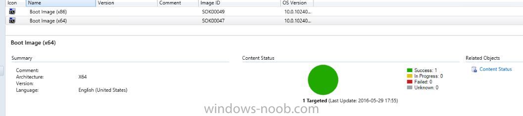

make sure to distribute (and enable for pxe) both architecture boot wim's
not according to this
Warning: Matching Processor Architecture Boot Image (0) not found SMSPXE 2016-05-27 14:25:49 4456 (0x1168)
the message means it cannot find a boot image matching the architecture of the machine that is booting, so check again, that you have enabled for PXE both boot images (x86 and x64) and distributed them to your distribution points...

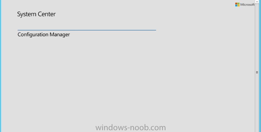

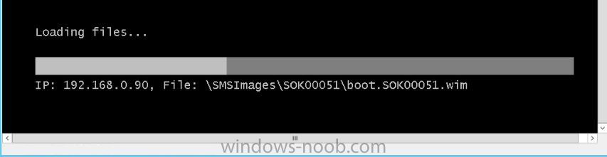

Hi Thanks for your response..
It works better now, the problem now is to start will not go further, see below...
I have done -->
  • Operating System Images
  • Operating System Upgrades Packages
  • USM Migration Tool for Windows 10
What I have missed, log files ?
