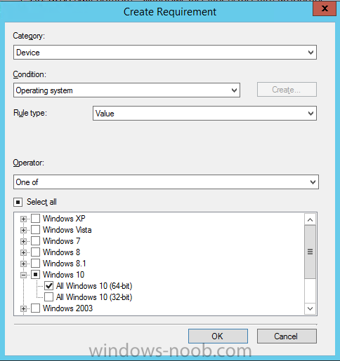

so do you want to separate apps by architecture in order to target operating systems with different architecture ?
you can use deployment types to define what software gets installed on what architecture, look at the Requirements tab and select an os with a specific architecture, that way the software will only install if the requirements are met (eg: is x64)
you can of course then target (deploy) that app to a specific collection containing only the architecture matching the requirement,.
