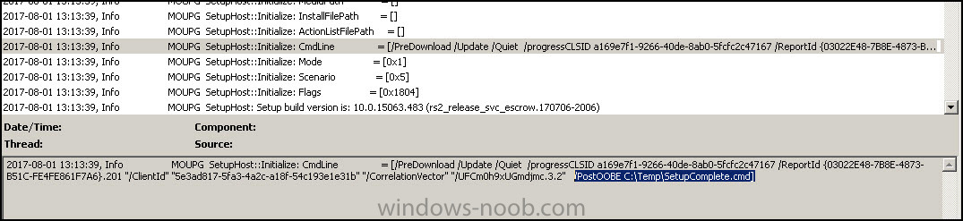

Okay, here's the problem I've been experiencing today.  The feature update will not install if the SetupConfig.ini file points to %WINDIR%\Setup\Scripts\ .  Just as soon as I removed it from the WSUS folder, it installed.  I guess the installation must read the INI file at the early stages of the deployment?

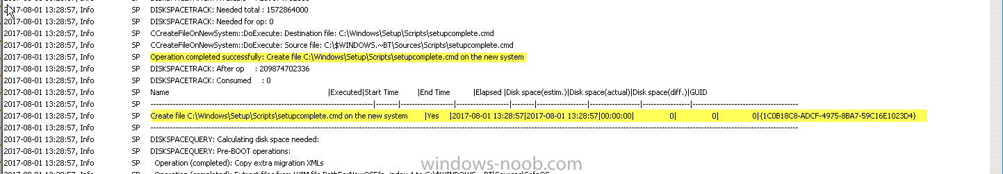

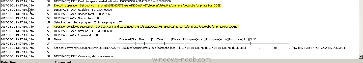

I drilled through your log file and the .ini file is definitely working as the /PostOOBE switch is correctly set to C:\Temp\SetupComplete.cmd. But obviously your custom script is not running even though the PostOOBE phase completes successfully. I am still testing on my end.

I apologize for not being clearer. Don't edit the setupconfig.ini file to look to %WINDIR%\Setup\Scripts\, leave the default settings but place your SetupComplete.cmd file in %WINDIR%\Setup\Scripts\ prior to the upgrade. This is a long shot and is independent of SCCM. Per https://docs.microsoft.com/en-us/windows-hardware/manufacture/desktop/add-a-custom-script-to-windows-setup, this script will run before the logon screen appears. Even in your setupact.log this file is created and runs.
