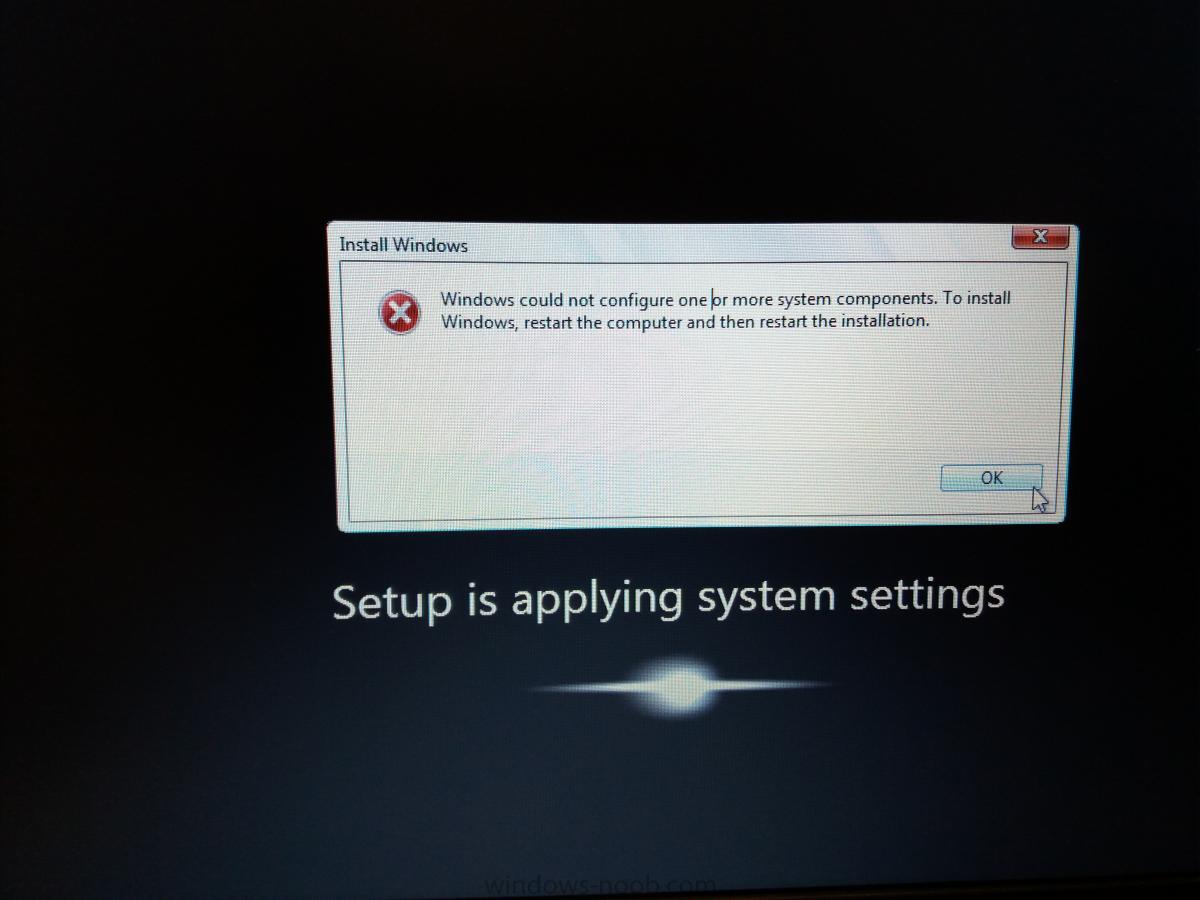

kesh Posted July 1, 2016 Report post Posted July 1, 2016 (edited) I have setup my OSD TS for Windows 7 and 10. The process goes through fine. When you look at the process, it even says installing drivers. However the TS fails with error code 0x80004005. once you reboot the machine, the OS, SCCM client, etc are installed fine but none of the drivers are installed. I have tried both deploying drivers via Auto Apply Drivers and also via Driver Package but i still get the same problem. I have looked at the logs, but can not figure it out. I have atatched my smsts.log file smsts.log Edited July 1, 2016 by kesh Quote Share this post Link to post Share on other sites More sharing options...

kesh Posted July 5, 2016 Report post Posted July 5, 2016 sorry there it is atatched now. i have also attached a pic of the error from the Win 7 TS. Sorry i missed the error when it came up and could not get the logs as requested. I do have the WinPE drivers injected into my bott wim already. smsts-20160701-131411.log Quote Share this post Link to post Share on other sites More sharing options...
anyweb Posted July 5, 2016 Report post Posted July 5, 2016 ok your failure is shown below and is repeated a few times in the log, basically dism can't inject any drivers... <![LOG[Executing command line: "X:\WINDOWS\system32\dism.exe" /image:"C:" /windir:"WINDOWS" /apply-unattend:"C:\_SMSTaskSequence\PkgMgrTemp\drivers.xml" /logpath:"C:\_SMSTaskSequence\PkgMgrTemp\dism.log"]LOG]!><time="12:45:52.993-120" date="07-01-2016" component="OSDDriverClient" context="" type="1" thread="1764" file="commandline.cpp:828"> <![LOG[Process completed with exit code 50]LOG]!><time="12:45:53.072-120" date="07-01-2016" component="OSDDriverClient" context="" type="1" thread="1764" file="commandline.cpp:1124"> <![LOG[uExitCode == 0, HRESULT=80070032 (e:\nts_sccm_release\sms\client\osdeployment\osddriverclient\sysprepdriverinstaller.cpp,548)]LOG]!><time="12:45:53.087-120" date="07-01-2016" component="OSDDriverClient" context="" type="0" thread="1764" file="sysprepdriverinstaller.cpp:548"> <![LOG[Dism failed with return code 50]LOG]!><time="12:45:53.087-120" date="07-01-2016" component="OSDDriverClient" context="" type="3" thread="1764" file="sysprepdriverinstaller.cpp:548"> <![LOG[AddPnPDriverToStore( pszSource, sTargetSystemDrive, sTargetSystemRoot, wProcessorArchitecture), HRESULT=80070032 (e:\nts_sccm_release\sms\client\osdeployment\osddriverclient\sysprepdriverinstaller.cpp,658)]LOG]!><time="12:45:53.087-120" date="07-01-2016" component="OSDDriverClient" context="" type="0" thread="1764" file="sysprepdriverinstaller.cpp:658"> <![LOG[Failed to add driver to driver store. Code 0x80070032 it looks like you are using an unsupported combination of boot media/dism and that's why it's failing to install drivers what version of SCCM is this ? what version of the ADK have you got installed ? and what version of boot wim are you using in this task sequence ? (press f8 and do ver) Quote Share this post Link to post Share on other sites More sharing options...

anyweb Posted July 6, 2016 Report post Posted July 6, 2016 well you shouldn't be deploying Windows 10 with that version of the ADK or with those boot images, there are ways of doing it but they are all workarounds, you need to uninstall ADK 8.1, then reboot, install Windows ADK 1511, and update your boot images after that, then try the task sequence again... here's how to do that https://www.windows-noob.com/forums/topic/12852-how-can-i-upgrade-to-system-center-2012-r2-sp1-with-mdt-2013-update-1-integrated/ Quote Share this post Link to post Share on other sites More sharing options...
