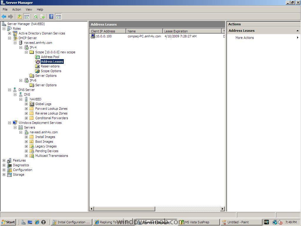

  On 11/19/2009 at 9:09 PM, anyweb said:
did you configure a DHCP server ?
Yes, i have configured, below i will attach scree shots. also in WDS i have configured the DHCP options.
Port 67 and 60 is also set in WDS for the DHCP (both options are checked).
I have done the follwoing configurations: Avaiable at: http://technet.microsoft.com/en-us/library/cc770637(WS.10).aspx#BKMK_2
