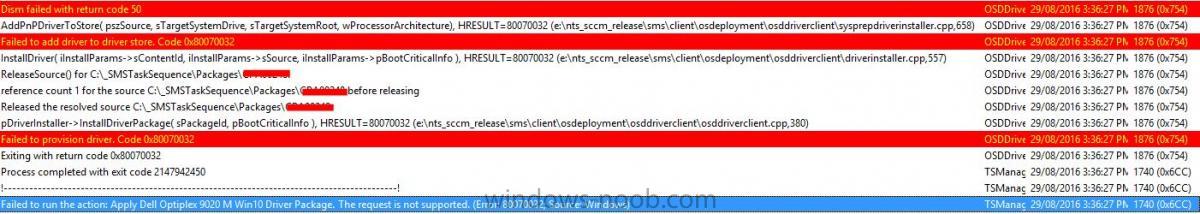

SCCM 1606 and are in the process of developing our Windows 10 v1607 SOE and have currently run into an OSD Driver Install issue.
We have packaged Dell CAB drivers for E7240, 9020 M/SFF/AIO and added them to an OSD task sequence. The task sequence completes the build, however we find that drivers are not installing. The SMSTS log shows the following errors (Please see screen dump)
Our Windows 7 and Windows 8 OSD task sequences have been setup in the same way and we don't have any of these issues, it appears that it only affects Win 10 OSD deployments.
Any thoughts?
1 answer to this question
I think this one is resolved, just need to do one more to test to confirm this. I've also had a look into the dism.log file and found the version of dism.exe being used is 6.3.9600.16384 which is for Win 8.1 ADK as a result will not work for Win 10 1607. Creating new boot wims, will let you know the results.
