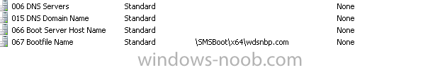

I don't believe you need any DHCP options configured if you are using IP-Helpers to direct the DHCP and PXE boot requests. I think the bootfile name is where you are having the problem since they are different for UEFI and BIOS (if I recall correctly). If you take everything out of DHCP in regards to PXE and let the IP Helpers do their thing, the DHCP server will reply back with what it knows and the ConfigMgr/WDS/PXE will respond back with what it knows about its services. Then things should work.
I referenced this when we moved from BIOS to BIOS and UEFI and had similar issues https://technet.microsoft.com/en-us/library/Cc732351%28v=WS.10%29.aspx#Updating
I see though you have option 66 and 67 in the screenshots. I don't believe you need those and if they are still present could be causing a problem.

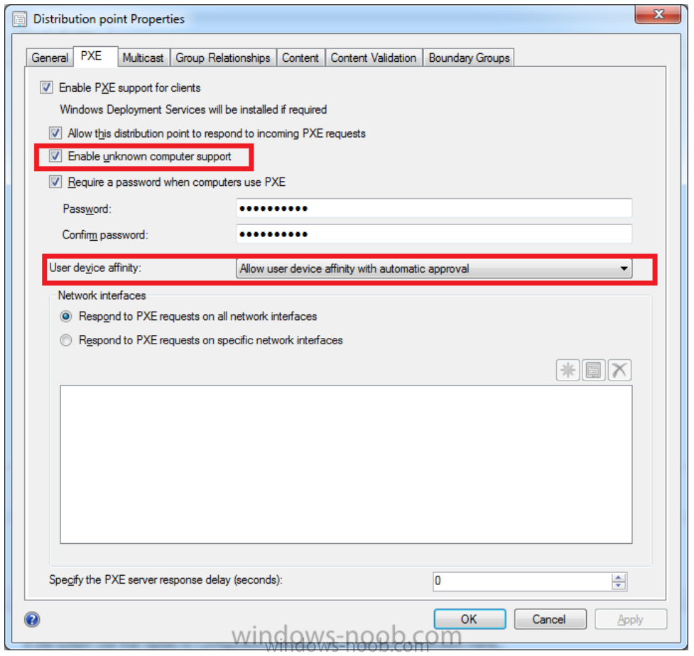

I had some issues where the PXE server response delay (Distribution Point Properties > PXE Tab) was set to the wrong value. I have mine set now to 5 and it works, but before it was either too low (0) or too high (30). Can't remember which but you might try changing yours from 0 to 5 and see if anything changes.

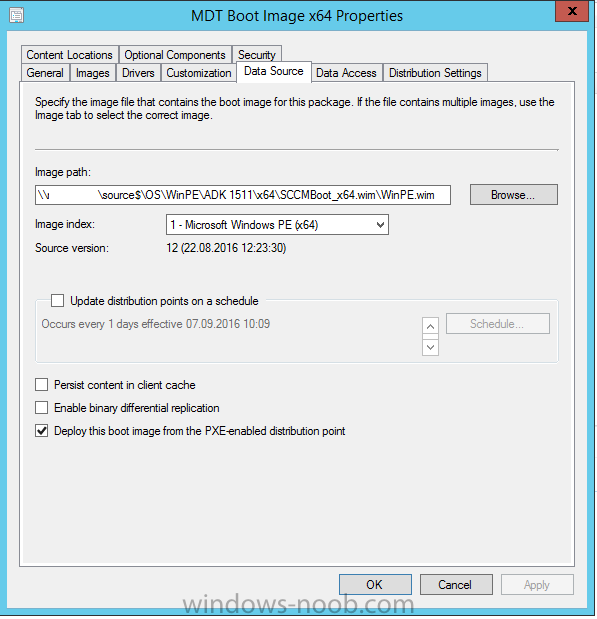

Also doing an "update distribution point" for your bootimages tends to fix odd issues when PXE stops working.
